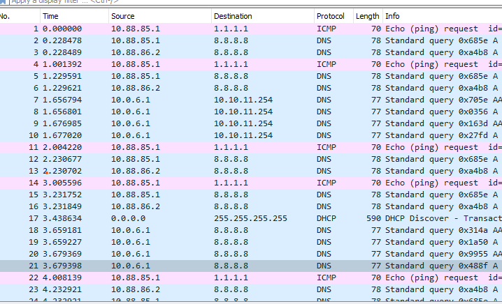

Traffic originating from “internet” (IP1) works and i can ping the mikrotik (IP2).
Traffic originating from Mikrotik (IP2) does not work and i can not ping the “internet” (IP1)
(ping says timeout )

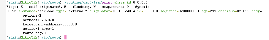

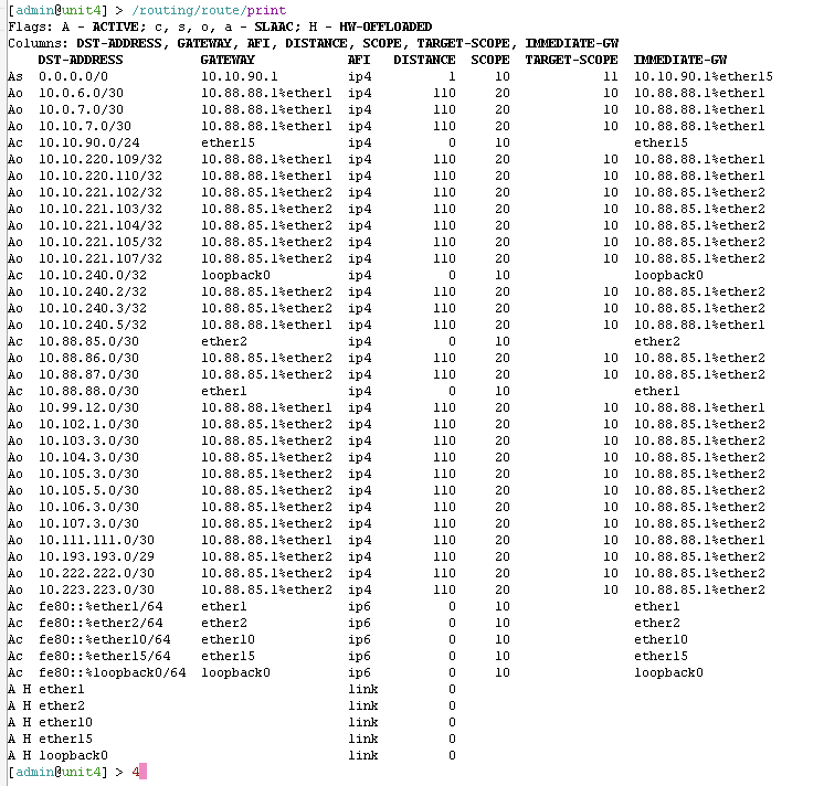

From Unit 4

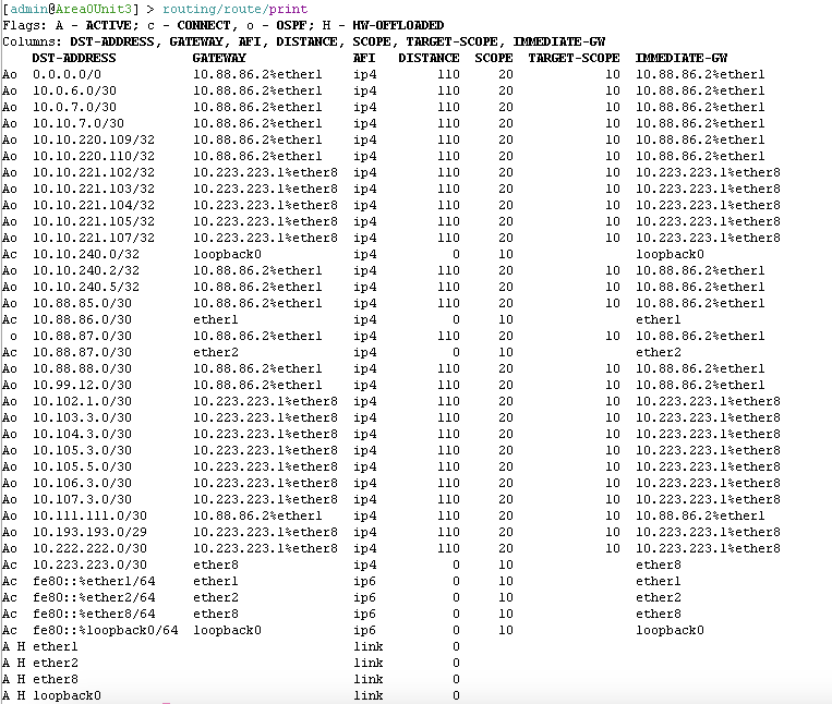

From unit 3
The loopback 10.10.240.0/32 is duplicated on R3 and R4. It shows as a connected route on both.
Hi. I fixed that issue.
Traffic still arrives at Unit 4. (it now looks like this)

Ao  10.10.240.2/32       10.88.85.1%ether2  ip4        110     20            10  10.88.85.1%ether2
Ao  10.10.240.3/32       10.88.85.1%ether2  ip4        110     20            10  10.88.85.1%ether2
Ac  10.10.240.4/32       loopback0          ip4          0     10                loopback0
Ao  10.10.240.5/32       10.88.88.1%ether1  ip4        110     20            10  10.88.88.1%ether1
Ac  10.88.85.0/30        ether2             ip4          0     10                ether2
Ao  10.88.86.0/30        10.88.85.1%ether2  ip4        110     20            10  10.88.85.1%ether2
Ao  10.88.87.0/30        10.88.85.1%ether2  ip4        110     20            10  10.88.85.1%ether2
Ac  10.88.88.0/30        ether1             ip4          0     10                ether1
Ao  10.99.12.0/30        10.88.88.1%ether1  ip4        110     20            10  10.88.88.1%ether1
Ao  10.102.1.0/30        10.88.85.1%ether2  ip4        110     20            10  10.88.85.1%ether2
Ao  10.103.3.0/30        10.88.85.1%ether2  ip4        110     20            10  10.88.85.1%ether2
Ao  10.104.3.0/30        10.88.85.1%ether2  ip4        110     20            10  10.88.85.1%ether2
Ao  10.105.3.0/30        10.88.85.1%ether2  ip4        110     20            10  10.88.85.1%ether2
Ao  10.105.5.0/30        10.88.85.1%ether2  ip4        110     20            10  10.88.85.1%ether2
Ao  10.106.3.0/30        10.88.85.1%ether2  ip4        110     20            10  10.88.85.1%ether2
Ao  10.107.3.0/30        10.88.85.1%ether2  ip4        110     20            10  10.88.85.1%ether2
Ao  10.111.111.0/30      10.88.88.1%ether1  ip4        110     20            10  10.88.88.1%ether1
Ao  10.193.193.0/29      10.88.85.1%ether2  ip4        110     20            10  10.88.85.1%ether2
Ao  10.222.222.0/30      10.88.85.1%ether2  ip4        110     20            10  10.88.85.1%ether2
Ao  10.223.223.0/30      10.88.85.1%ether2  ip4        110     20            10  10.88.85.1%ether2
Ac  fe80::%ether1/64     ether1             ip6          0     10                ether1
Ac  fe80::%ether2/64     ether2             ip6          0     10                ether2
Ac  fe80::%ether10/64    ether10            ip6          0     10                ether10
Ac  fe80::%ether15/64    ether15            ip6          0     10                ether15
Ac  fe80::%loopback0/64  loopback0          ip6          0     10                loopback0
A H ether1                                  link         0
A H ether2                                  link         0
A H ether10                                 link         0
A H ether15                                 link         0
A H loopback0                               link         0
Seems like traffic is not sent from loopback0 / Router-ID IP but from the ether1 and ether2 adresses
Any idea??
