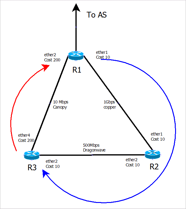

I think I’m running into an issue with a two-hop path versus a single hop path, but I don’t know how to fix it.
We’re interconnecting the site at R3 with another site with R1 and R2. R1 and R2 are interconnected with 1 Gbps at one location. R2 is connected to R3 with a 490 Mbps microwave link. So the interfaces going between R1->R2->R3 are all set to cost 10. The link between R1 and R3 is only 10 Mbps; useful as a backup, but not the primary link.
If I turn off ether4 at R3, routing works as expected. However, if I turn on R3/ether4, then routing goes as shown with the arrows. Traceroute to the cloud goes via the red path. Traceroute from the cloud to R3 goes via the blue path.
Looking at routes, the active route is the blue path.
The OSPF instance at all three sites is as below.
Can someone tell me why outbound traffic is taking the red path despite the cost?

Is your default route being flooded from a router not in the picture? Is it being exported as type 2 and not type 1?
We have all the export settings = no (the default setting).
How would I tell if the default route is being flooded?
Post a /ip route print from each router.
Where is the default route coming from? Or is there no default?
I would check the routing table at R3 and also the LSAs being received at R3.
This fixes the problem:
/ip dhcp-client set 0 default-route-distance=200
The thing that was confusing me was that the /routing ospf route table showed the correct route, but was being over-ridden by the default route in /ip routes table.
Is that on R3? Is there a reason not to use static IP assignments on that router?
That’s what broke it, I believe. Switched it to DHCP, and you can set the distance when the static is applied.
dont run default route not comming from ospf it self With ospf
Why do you even have dhcp enabled?
It’s a backup link on a PMP subnet.
Yeah, OSPF should take care of the backup.
