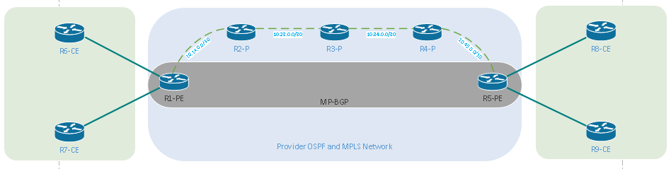

I need help with the following issue I am experiencing. I am trying to establish an OSPF adjacency between my CE (client edge) and PE (provider edge) with VRF set up on my PE.
The adjacency establishes fine when disabling the VRF as connectivity between the two devices is perfect without any routing marks.
When enabling the VRFs though, the adjacency terminates.
Please find below PE and CE configurations:

Flags: X - disabled, I - inactive, D - dynamic, P - passive
INTERFACE COST PRIORITY NETWORK-TYPE AUTHENTICATION AUTHENTICA
0 DP loopback 10 1 broadcast none
1 D ether1 10 1 broadcast none
Please let me know if you need additional information.
Thanks.
Interface should be dynamically added if you created corresponding ospf network.
You created separate ospf instance for this ipvpn, right?
