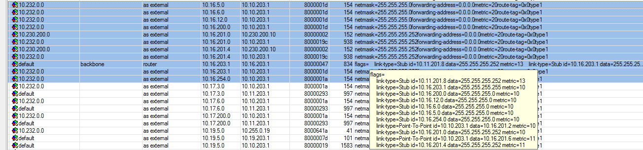

SG forms lsadb generating lsa5 (as external) for networks of the neighbors router from the same zone (0.0.0.0). I think all this there have to be lsa3. From a zone 10.232.0.0 (linux+bird) the “correct” lsa arrive.
Information transfer from a router 10.16.203.1 in area 10.232.0.0 works only at inclusion of redistribute-other-ospf
sg - 10.10.203.1
kh - 10.16.203.1
.. работает только при включении redistribute-other-ospf

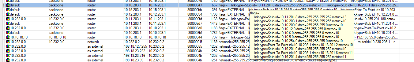

Also:
Flag external isn’t set. The router of KH means doesn’t inject external routes.
instance=default area=backbone type=router id=10.16.203.1
   originator=10.16.203.1 sequence-number=0x8000004D age=1074 checksum=0xCBD9
   options="E" body=
     flags=
         link-type=Stub id=10.11.201.8 data=255.255.255.252 metric=13
         link-type=Stub id=10.16.203.1 data=255.255.255.255 metric=10
         link-type=Stub id=10.16.200.0 data=255.255.255.0 metric=10
         link-type=Stub id=10.16.12.0 data=255.255.255.0 metric=10
         link-type=Stub id=10.16.6.0 data=255.255.255.0 metric=10
         link-type=Stub id=10.16.5.0 data=255.255.255.0 metric=10
         link-type=Stub id=10.16.254.0 data=255.255.255.0 metric=10
         link-type=Point-To-Point id=10.10.203.1 data=10.16.201.2 metric=10
         link-type=Stub id=10.16.201.0 data=255.255.255.252 metric=10
         link-type=Point-To-Point id=10.10.203.1 data=10.16.201.6 metric=11
         link-type=Stub id=10.16.201.4 data=255.255.255.252 metric=11

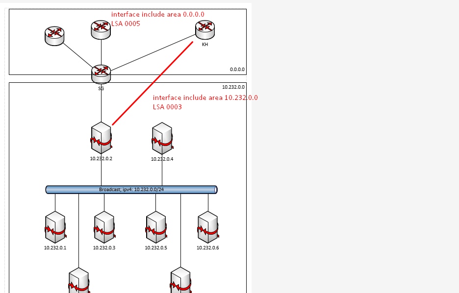

I don’t need summation. It is necessary that the networks (10.16.203.1) connected to mikrotik were transferred to the neighboring area as “routes to other area” - lsa 3. Now they are given to other zone as “routes of other domains of routing” - LSA3
The routes transferred from a area 10.232.0.0 (bird/linux is used) are LSA 3/4. Routes LSA5 transferred in a area 0.0.0.0 (mikrotik) even in a area always
Similar situation in the same OSPF domain. area 10.255.0.0
From bird LSA 3 come - and it is correct. Mikrotik creates LSA5 including all networks external.
And again - you need routers in different areas.

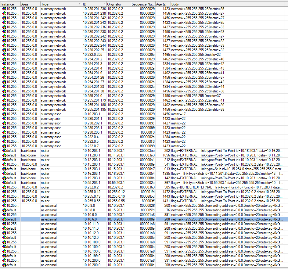

Maybe its generates LSA type 5 cause of default route?
Maybe. I have peeped at the stand at the colleague: are collected 2 microthat in ospf through ptp. In lsadb of the record lsa1 (router) - in body all networks are described. There is no flag of external.
lsa5 - here have got all networks.
Any record lsa3. Is it normal??? Mikrotik always ASBR
