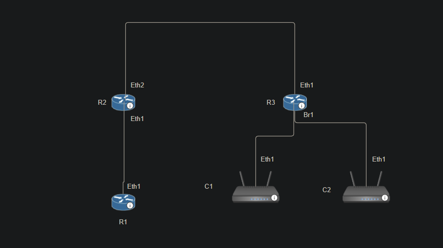

I would like to give credit where credit is due! I had my doubts but Mikrotik stuck true to their word, and in v7.18.1 I have just tested the handling of dhpv6 relay routes to be working via the store relayed bindings setting. On my site to site ospfv3 instance I redistribute dhcp, with the dhpv6 relay handling the routing to the client.
Thank you Mikrotik team!
Would you please share your configuration?
There is a lot of config on those routers so I just make a mock up config containing (hopefully) every piece of relevant data. one thing i didnt add was the router-id for all the ospf instances is set to a loopback address on each device as per mikrotik ospf guidelines. R2 is pretty irrelevant in this example but there was multiple L2 sites between R3 where i set up the relay and R1 where the server is so I included it.
R1:
ipv6/address/add address=xxxx:xxxx:1:: interface=ether1
ipv6/pool/add prefix=xxxx:xxxx:xxxx:xxxx/49 prefix-length=60
ipv6/dhcp-server/add interface=ether1 prefix-pool=pool1
routing/ospf/instance/add redistribute=connected,static
routing/ospf/area/add area-id=0.0.0.0 instance=default-v3 name backbone-v3
routing/ospf/interface-template/add interfaces=ether1 type=ptp area=backbone-v3
R2
routing/ospf/interface-template/add interfaces=ether1,ether2 type=ptp area=backbone-v3
R3
routing/ospf/instance/add redistribute=connected,static,dhcp
ipv6/address/add address=xxxx:xxxx:2:: interface=bridge1
ipv6/dhcp-relay/add dhcp-server=xxxx:xxxx:1:: interface=bridge1 store-relayed-bindings=yes
C1,C2
ipv6/dhcp-client/add pool-name=pool1 use-peer-dns=yes add-default-route=yes request=prefix pool-prefix-length=64 interface=ether1
ipv6/address/add address=::/64 from-pool=pool1 advertise=yes
