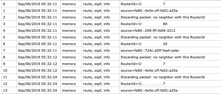

I have two CCR1036-8G-2S+ with RouterOS 6.45.5 multiple parallel/same vlan’s. ( same problem with older versions )
The system log’s is flooded with this
And the two get full sync in some vlan’s but not in all. I think the problem is based on same EUI-64 Link-Local who i can’t change and either change the mac. Creating bridges to solve the mac-problem is not an alternative here.
I have tested to change almost allt parameters with same result. Network type, stub zone with other areas etc.
Any ideas?

I believe this problem was discussed here:
http://forum.mikrotik.com/t/ospfv3-adjacency-with-cisco-routers/132780/1
The workaround was to run two OSPF instances since there is no way to change the link local
I have tried multiple instances, area id, stub area etc but there are always same problem.
