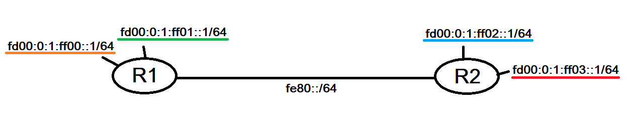

In my basic two-router test, I attempt to advertise two stub prefixes per router to the neighboring router over a link with only IPv6 link-local addressing (no other associated prefix). A sketch of the simple topology is below with the prefixes color-coded to avoid your eyes glazing over from the nearly-identical hexadecimal :smiley:. Exports of :ipv6 and :routing are attached, but they are essentially trivial. (For full disclosure, this link is actually a GRE tunnel, but that doesn’t seem likely to have any relevance in this situation.)

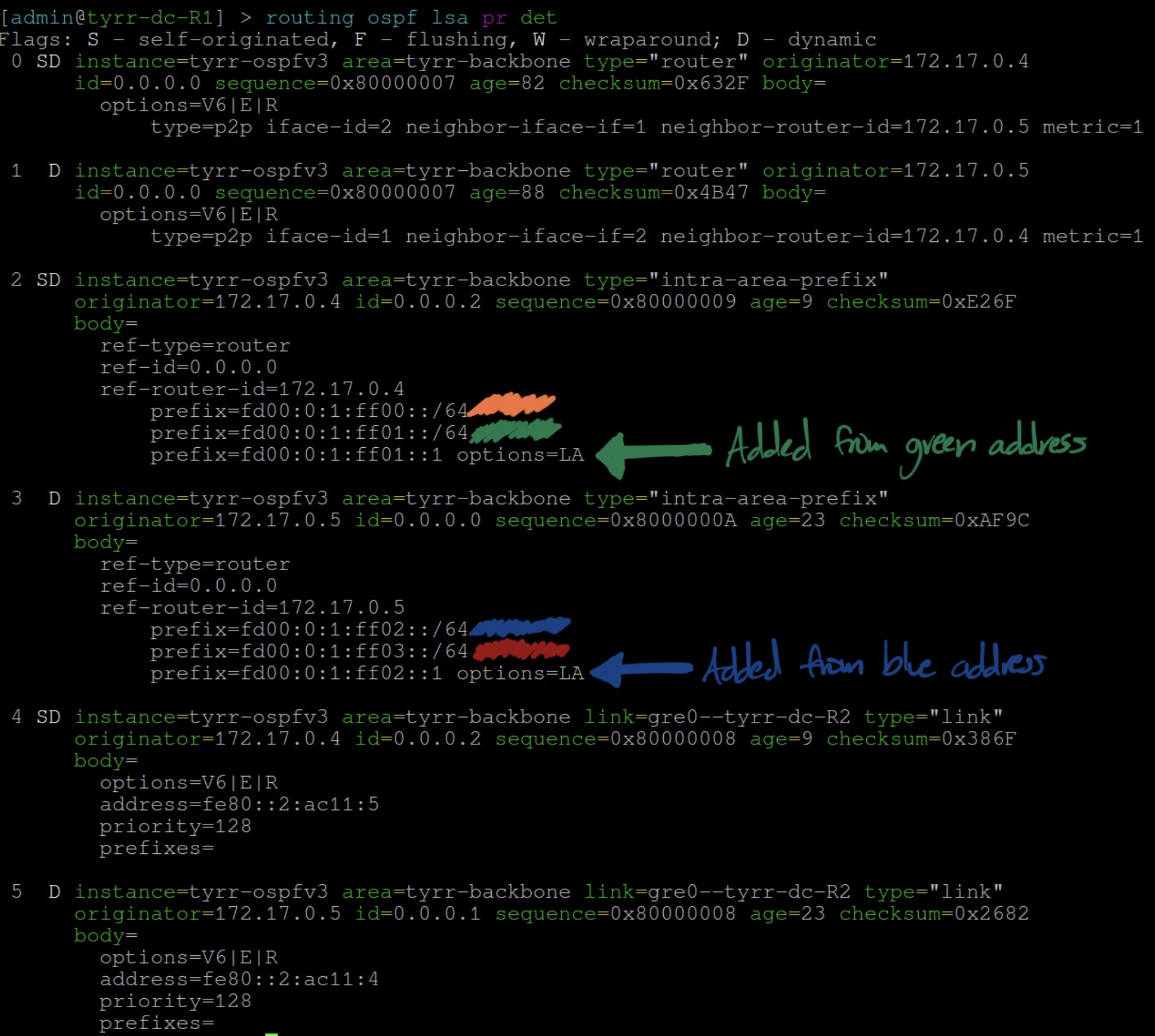

When inspecting the link state database, each router includes all of the expected prefixes. In addition to the expected prefixes, however, each router chooses to include one of its own non-link-local interface addresses as a /128 with the LA bit set. Here is what this looks like, again color coded for easy comparison.

Referencing the section of the RFC pertaining to type-9 LSAs (section 3.4.3.7) [1], there seems to be some very specific and fiddly logic around when this should happen. The link between R1 and R2 is not a point-to-multipoint link or a loopback, but it is a point-to-point link without an assigned prefix. In this case, it would make sense for the router to proceed with selecting one of its available addresses, setting the LA bit, and including it as a /128.

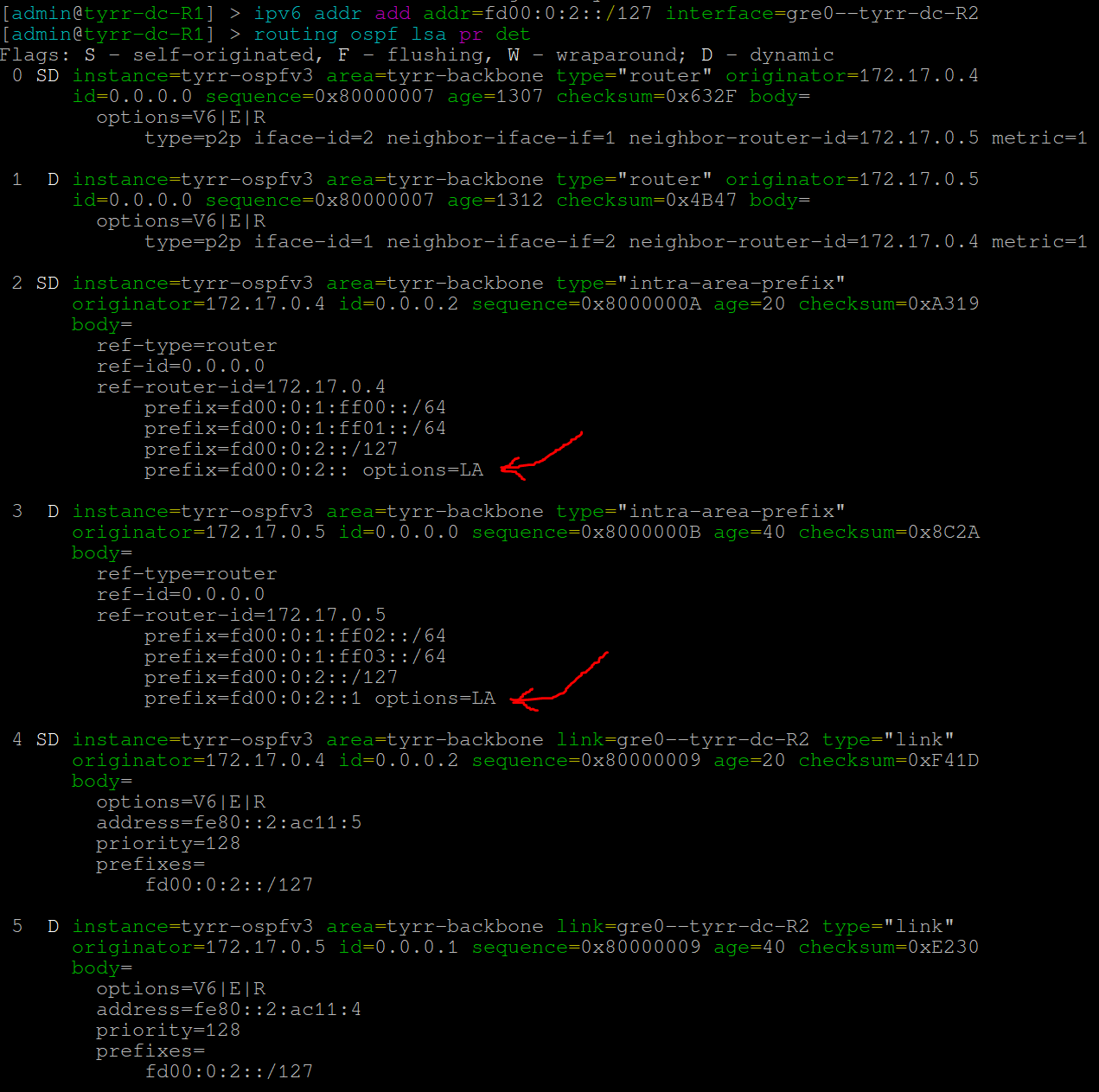

In an attempt to avoid this, I assigned a prefix to the R1 to R2 link (fd00:0:2::/127). Unfortunately, the routers simply selected the new addresses on the R1 to R2 link and included that as a /128 to its neighbor:
