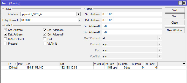

  • VoIP traffic (dst :5060-tcp/udp, :10000_20000-udp) to go through VPN_A, this goes wrong.
This is because the VoIP server initiates the connection. Strange enough I can see the packets comming back at VPN_A!
The packets already have the right destination address, so that’s easy.

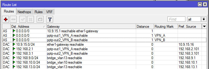

This is my route list:

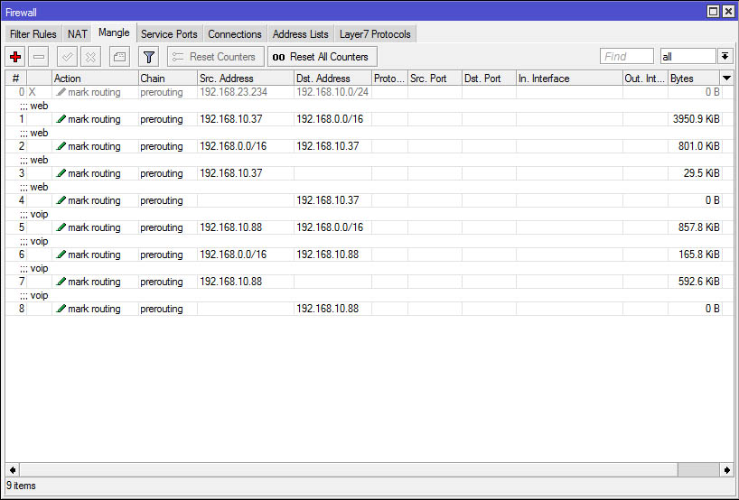

As you already suggested, I have added some rules to mark the packets on their way back (line 8 ).
Lines 1,2 are marked ‘main’
Lines 3,4 are marked ‘VPN_B’
Lines 5,6 are marked ‘main’
Lines 7,8 are marked ‘VPN_A’
Could you please look over it and tell me where I’m wrong? I have at both the webserver and VoIP server the same problems, also ping packets behave the same.

Try upload your config using /export output - it gives a more comprehensive picture than screenshots. It looks as if you added a rule to mark packets headed for the relevant subnet - but that was not what I meant. What I meant was to have a valid route to the subnet for the relevant routing table (i.e. a routing entry with the relevant routing mark).

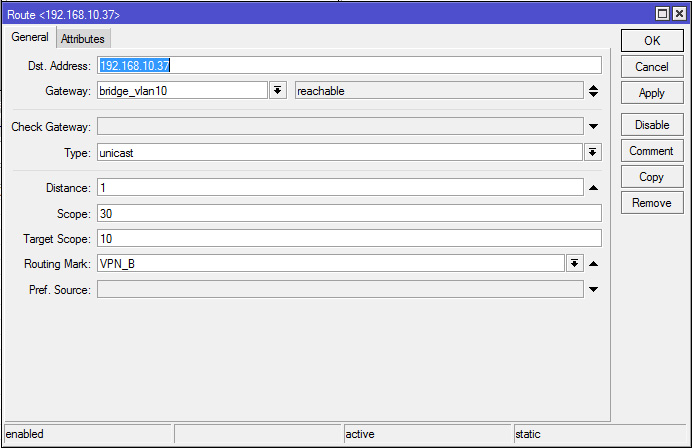

Try adding routes to the relevant source subnets which have the associated routing mark.
e.g. - Add a route to 192.168.10.0/24 with routing mark = VPN_B (same interface etc. as existing dynamiclayy created route in main table.
The documentation mentions that main is a default/fallback routing table but I have seen situations where adding an explicit entry with a specific routing mark fixes problems.
I have tried to create an extra route to 192.168.10.37 (client) with routing mark = VPN_B with a distance of 1.
But, this does not work. What am I doing wrong? When I ping from 192.168.10.37 to 8.8.8.8 almost everything works. I can see the packets coming into the VPN_B torch with the right destination address..
Make that route to 192.168.10.0/24 rather than a single IP and then upload the current config again.
No, unfortunately that was not the right solution. Here is the current config.
