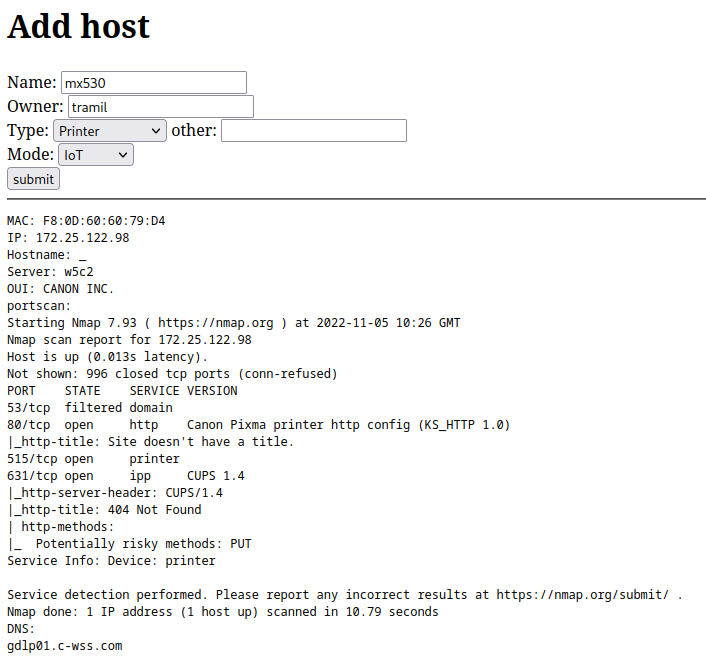

So, I’ve done this now, and it works quite well, but very hacky.
I installed a dhcp script to check if the current lease is dynamic and not a release, if so, call a CGI script on my server.
The CGI script sends the URL of another CGI script to my phone/laptop using keybase
I click on the link and get a form showing the host details, whether the MAC address is dynamic, and a lookup of the OUI of the MAC, an nmap of the IP and all DNS lookups by that IP done since the lease was acquired using pihole’s sqlite db. That will often indicate what the host probably is by its captive portal check, and other early DNS requests.
I fill in the form with the owner name, device type (laptop/iphone/printer/whatever), name, etc.
I submit the form and it makes the lease static, adds a comment with the above details, and puts the IP address into various address lists (devices owned by that person, printers, android phones, etc.)
If the mac address already exists but was on another SSID, I copy the details
Just have one thing left to do, which is update DNS and reverse DNS

In my case, I’m not so concerned about security of access to the network, as that’s basically up to knowledge of the WPA2/3 PSK. I’m more concerned with losing track of what I’ve added, and perhaps what these devices connect to. It’s more of an inventory process. For example, here’s what happens now if I add a printer:
https://i.postimg.cc/RCw9FN8b/printer.png
There’s only one DNS lookup there. If I add a phone there are dozens, depending how long I leave it before connecting to the config URL
