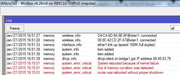

Out of memory 6.26rc6
Ruter is operating in bridge mode with 16 stations.
Routers with 32mb of ram easily go under 5mb of free ram. In this case they run out of cpu time with management and with flash activities. Only reboot solves the situation.
I wish mikrotik could work on memory consumption optimisation otherwise it looks more and more that 6.x is quite badly usable on 32mb devices.
