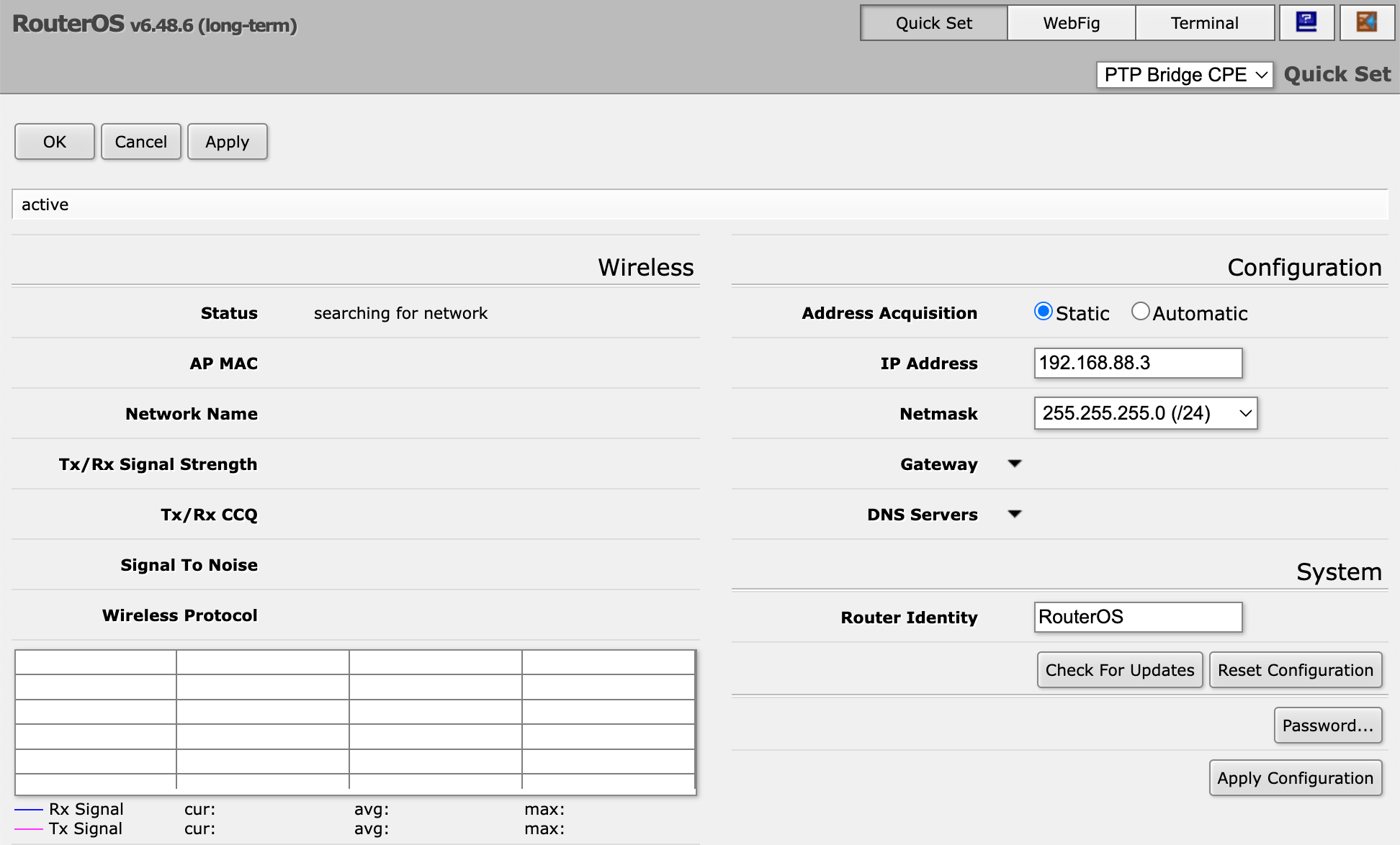

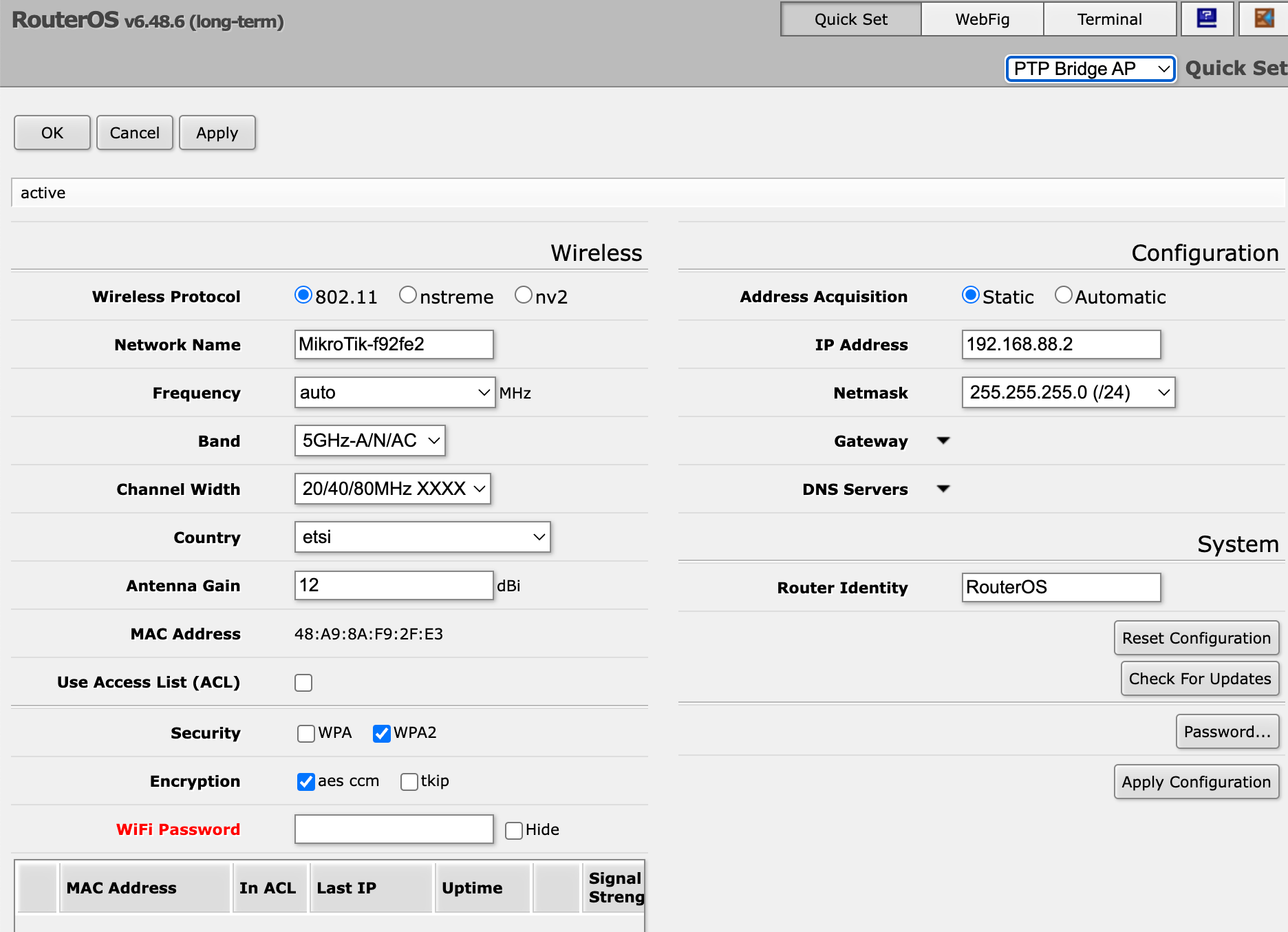

The devices are literally out of the box, I have not changed anything other than making sure the master is in PTP Bridge AP mode, and the Slave in PTP Bridge CPE. The devices are pointing at each other behind glass windows, approximately 30m apart (across a road, line of sight, no obstructions). The devices do not seem to connect to each other. The slave shows “searching for network” on the QuickSet page. The master appears to be missing a WiFi password on it’s QuickSet page, but this does appear in the export config. I changed the PW in the export configs uploaded here, using a single global find-and-replace (so that all of the “[PW redacted]” values were previously identical.
I have also reset configuration back to defaults on both units, in case they were shipped with something changed - this made no difference. I removed the serial numbers from the export output.
I would appreciate any tips or guidance .. as my experience with paired Mikrotik products in the past has been fantastic. This one baffles me.
Master:
# jan/02/1970 00:55:07 by RouterOS 6.48.6
# software id = 61XN-GRN5
# model = CubeG-5ac60ad
# serial number = xxxxxxxxxxx
add admin-mac=48:A9:8A:F9:2F:E2 auto-mac=no comment=defconf name=bridge
/interface wireless
set [ find default-name=wlan1 ] band=5ghz-a/n/ac channel-width=20/40/80mhz-XXXX disabled=no frequency=auto installation=outdoor mode=bridge ssid=MikroTik-f92fe2
/interface w60g
set [ find ] disabled=no mode=bridge name=wlan60-1 password=[**PW-redacted**] ssid=MikroTik-f92fe2
/interface w60g station
add comment=defconf mac-address=48:A9:8A:F9:2F:E3 name=wlan60-station-1 parent=wlan60-1 remote-address=48:A9:8A:F9:31:60
/interface bonding
add comment=defconf mode=active-backup name=bond1 primary=wlan60-station-1 slaves=wlan60-station-1,wlan1
set [ find default=yes ] authentication-types=wpa2-psk comment=defconf disable-pmkid=yes mode=dynamic-keys supplicant-identity=MikroTik wpa2-pre-shared-key=[**PW-redacted**]
/ip hotspot profile
add bridge=bridge comment=defconf interface=bond1
add address=192.168.88.2/24 comment=defconf interface=bridge network=192.168.88.0
/system identity
set name=RouterOS
Slave:
# jan/02/1970 00:48:03 by RouterOS 6.48.6
# software id = VNG7-HX4I
add admin-mac=48:A9:8A:F9:31:5F auto-mac=no comment=defconf name=bridge
/interface wireless
set [ find default-name=wlan1 ] band=5ghz-a/n/ac channel-width=20/40/80mhz-XXXX disabled=no frequency=auto installation=outdoor mode=station-bridge ssid=MikroTik-f92fe2
/interface w60g
set [ find ] disabled=no mode=station-bridge name=wlan60-1 password=[**PW-redacted**] ssid=MikroTik-f92fe2
/interface bonding
add comment=defconf mode=active-backup name=bond1 primary=wlan60-1 slaves=wlan60-1,wlan1
add name=WAN
add name=LAN
add interface=wlan1 list=WAN
add interface=bridge list=LAN
add address=192.168.88.3/24 comment=defconf interface=bridge network=192.168.88.0
/system identity
set name=RouterOS
