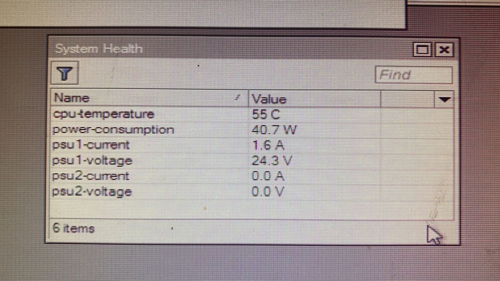

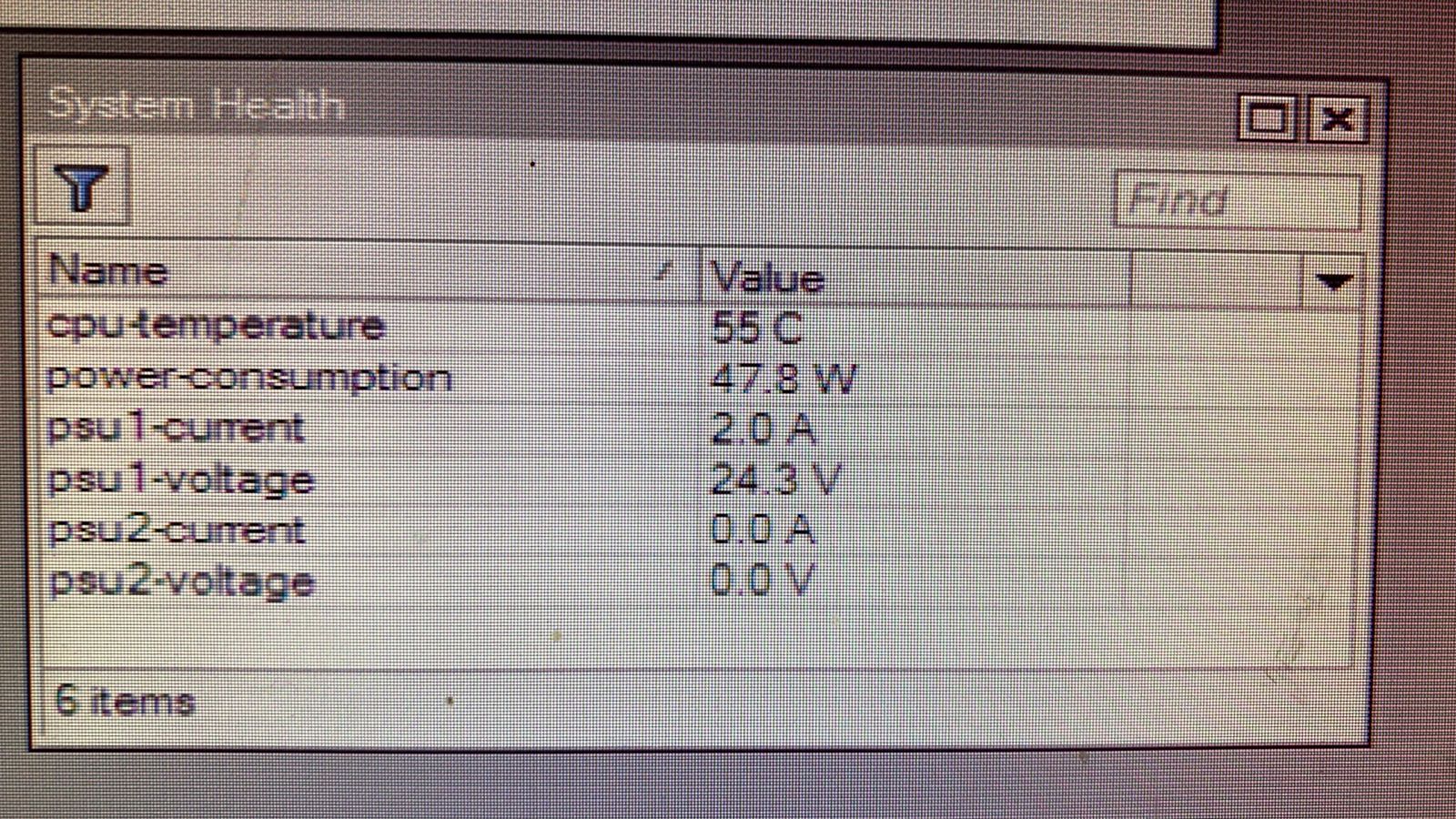

problems with the equipment netpower 16p in the temperature of the equipment is worrying or is it normal for the equipment?
As shown in the images, it does not vary within these numbers, the operating team is maintained
