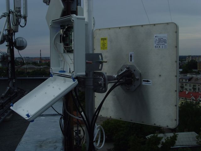

Outdoor TEST RB411AH +R52n Distance 1.51 KM + Mars Antennas
2x RB411AH + R52n Distance 1.51 KM + Mars Antennas DUAL 23DBI
Radio TX only 10dBm in center CITY KAUNAS!!!
See all in the pictures

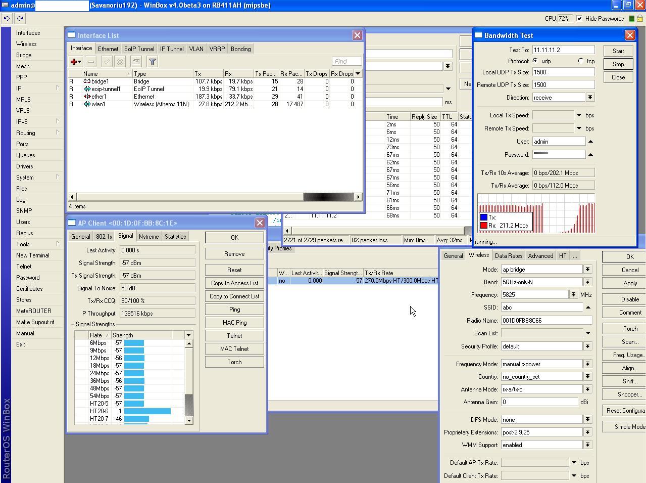

First resume:
best settings: first AP second station bridge with EOIP tunnel
bugs: not work with WDS mode and nstreem
i will post configs in this week.
link: distance:
http://maps.google.com/maps/ms?ie=UTF8&hl=lt&msa=0&ll=54.917277,23.938909&spn=0.017833,0.038452&z=15&msid=104004358681538305873.00046bef6c5a9a2725a52
TEST pictures:attached
best regards to Normis http://www.frineta.lt TEAM
in few days i will POST all configs mounting process…etc…

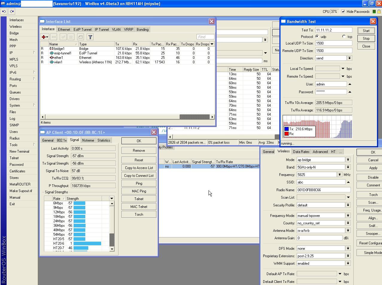

Can you run a TCP test?
realy link is not finished yet so it is not finaly results and i will post updates later! remember that test are rb to rb, 411ah is has not enouth CPU power to run normal TCP tests, later i i would test bridge ON PC to PC
Look here:
file attached on first post
N411AH.zip [977.9 KiB]
TCP-Test is useless for 11N. I’ve tested with 2x411AH connected with R52N and
2xRB450G directly connected with Cable. Both max out at ~80MBit TCP.
So it’s a CPU-Test and not a test of connection speed.
UDP gives 220MBit and ~500MBit.
Stefan
TOWER PICTURES
attached to zip:
tower mount.zip (517 KB)
Can you run UDP bandwith test in both directions with this setup? Do you reach 100 mbps full duplex?
Can you clarify this?
Do you mean that nstreme doesn’t work, and wds mode doesn’t work, or do you mean wds doesn’t work with nstreme?
I am trying a wds nstreme link not getting great results - frequent disconnects. WDS without nstreme seems somewhat better but 2-way speed tests kill the link or take it down to unusable speeds.
Randy
