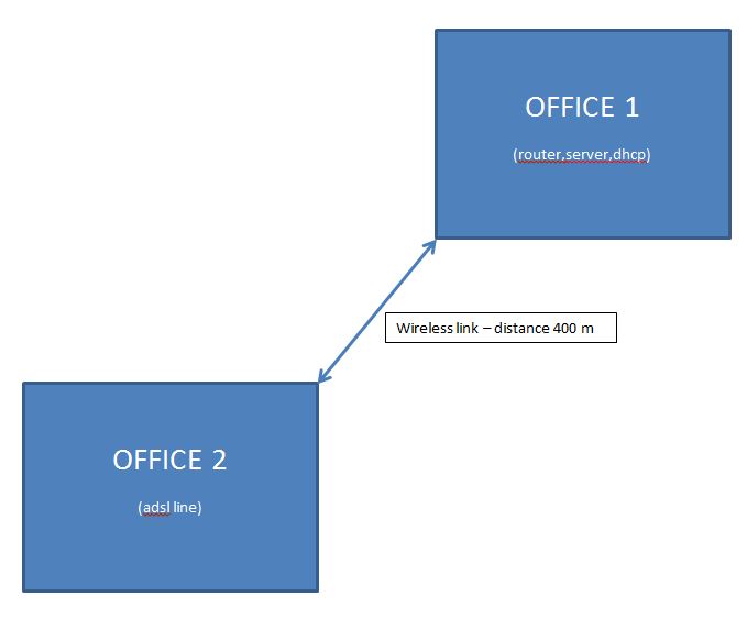

Hi, I have the following situation (picture below). I need to connect 2 offices wirelessly. The distance between the two offices is about 400m with line of sight. The speed (300Mbp+) and the stability of the link between the two offices is very important. Can someone suggest the best Mikrotik devices (outdoor wireless ap with antena) for the described situation?
