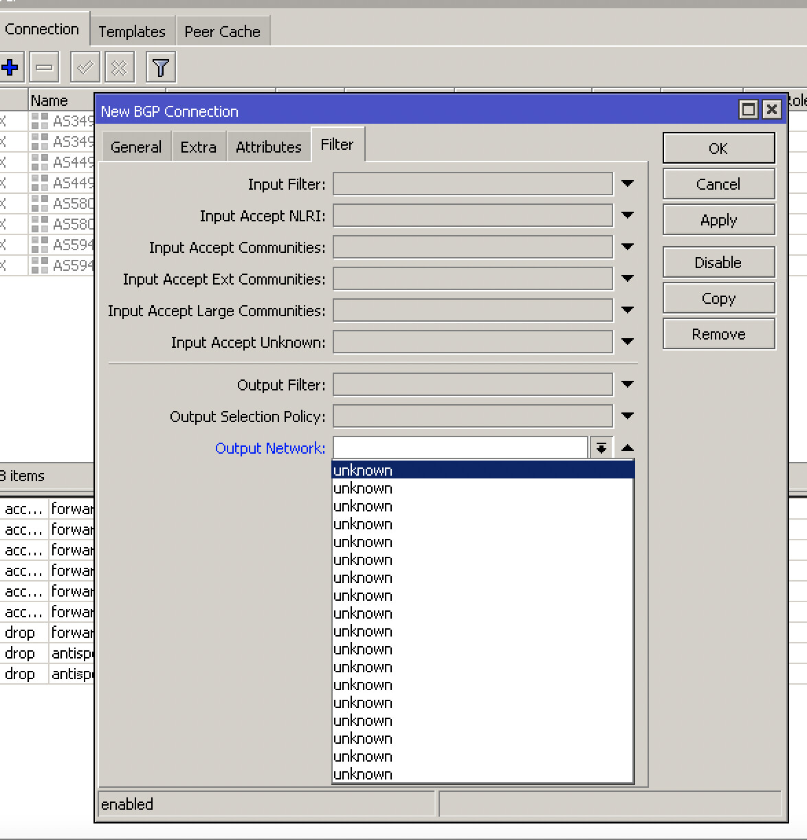

Output Network in BGP Peer on Winbox lists "unknown" in 7.1rc5
Weather there are some Networks in Address List or not, in this dropdown there ist always the word “unknown” in the menu.
See in Attached Screenshot.

When reporting an issue, please follow this template:
Version number (if the issue is upgrade related, specify which version was installed before as well);
→ Updated from 6.48.6 to 7rc.1 then all minor steps till rc5, error occured in every minor release
Router’s model;
→ CCR1036
Steps to reproduce the issue;
→ Add new BGP peer and open output-network dialog on the tab
Configuration export (use ‘/export hide-sensitive’ command);
Any additional information that would help troubleshoot the issue (screenshots, debug logs, etc.).
Thank you for the report, this is a winbox cosmetic issue, we will fix it in the next RC version.
Currently use CLI to set networks.
