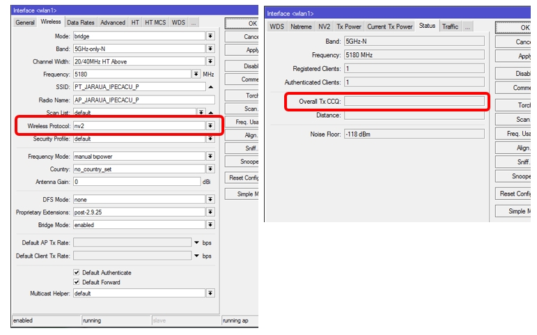

Dear, I am unable to get the value of “Overall TX CCQ” when I use NV2 protocol.
Link Configuration: radio 5SHPn Metal, Band 5GHz-only-N, firmware 3.07.
When I use the 802.11 wireless protocols and Nstreme the “Overall TX CCQ” is recorded, however, when I use NV2, I have shown some value in the field.
See the attachment.
You can tell how to collect the “Overall TX CCQ” with NV2?
I thank the help
Overall TX CCQ is not supported for Nv2 wireless protocol.
