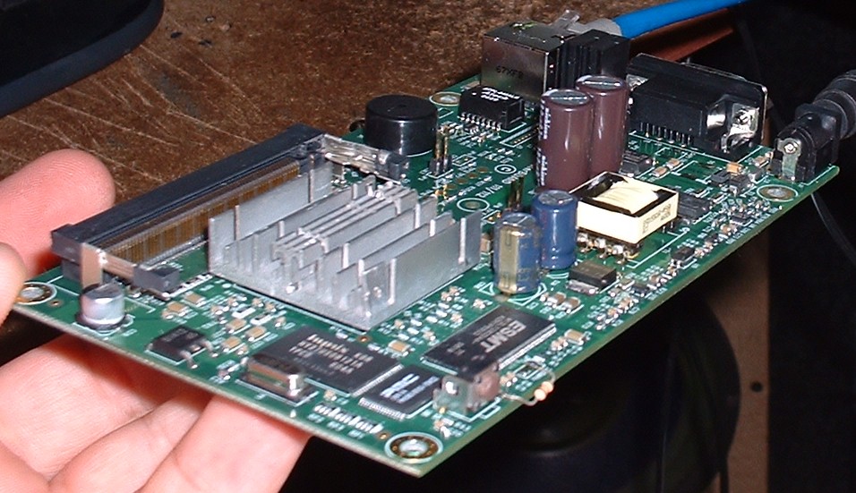

I setted RB112 to 200Mhz by adding 1khz resistor to R7 position and jumper on JP7. Works fine

Infineon reports that it will not be stable if you do this, but well - it’s your router and you are free to try.
Well this is rebelliously too late, but for those interested, this does work.
The rb112 are really too underpowered to do anything with and we have a room full of them, hence trying to revive them for something simple.
I would however like to know what is meant by not stable?
Ive been running a bandwidth test for hours thus far.
in that case - it works for you
Is it maybe just a matter of cooling?
As you can see because the board is underpowered i actually don’t use one of the Mini-PCI’s and have opted to attach a mini heat sink to the CPU. “Just In-case”
