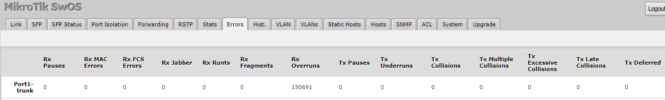

Overruns on CSS326-24G-2S+RM
Rx Overruns on CSS326-24G-2S+RM > 1000 for 1 hour on the uplink port. Traffic is a maximum of 40Mbps on this port. On other ports, traffic is less than 3Mbps and it is all going to the uplink port (all computers work only with the Internet - they do not communicate with each other).

I got the same problem! rx-overruns on the trunk port
i’m running with the latest version (2.7)

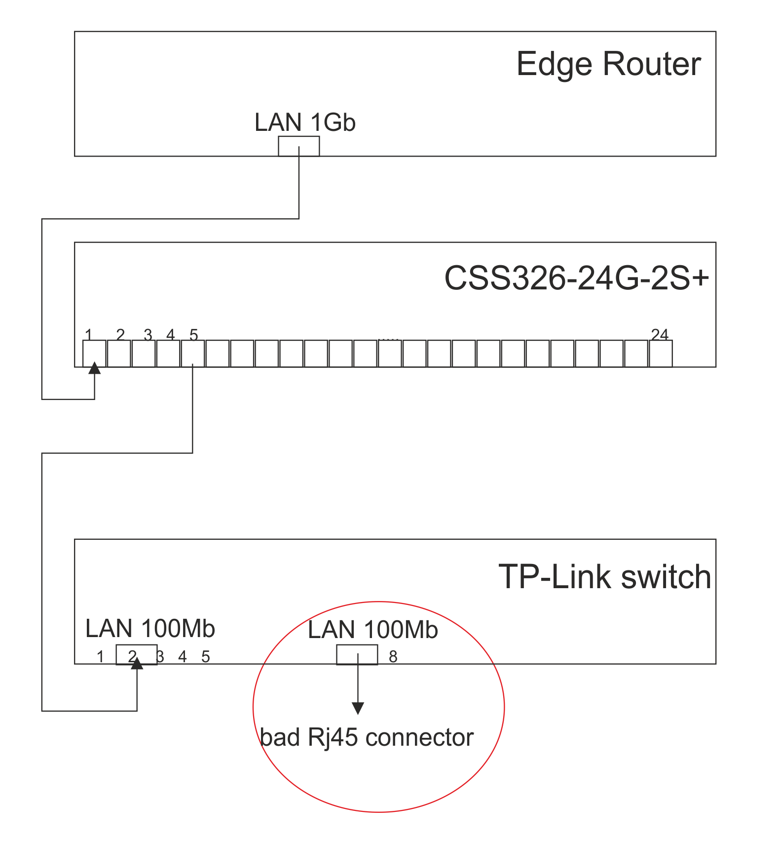

Hi
I had the same problem.
And I was trying to change firmware, switch ports, settings …
Uplink constantly gets more and more RX Overruns errors (more than 30000 in 12 hours), and a little later another port also get some RX Overruns errors (about 300 for the same time) connected at 100mb.
In the end, it turned out that one of the donwlinks on the remote 100mb switch has a faulty RJ45 connector (not a defective port).
EDIT:
after a few hours RX Overruns errors appears again. e.g. nothing is solved.
Switch is sended back to local dealer (RMA).
