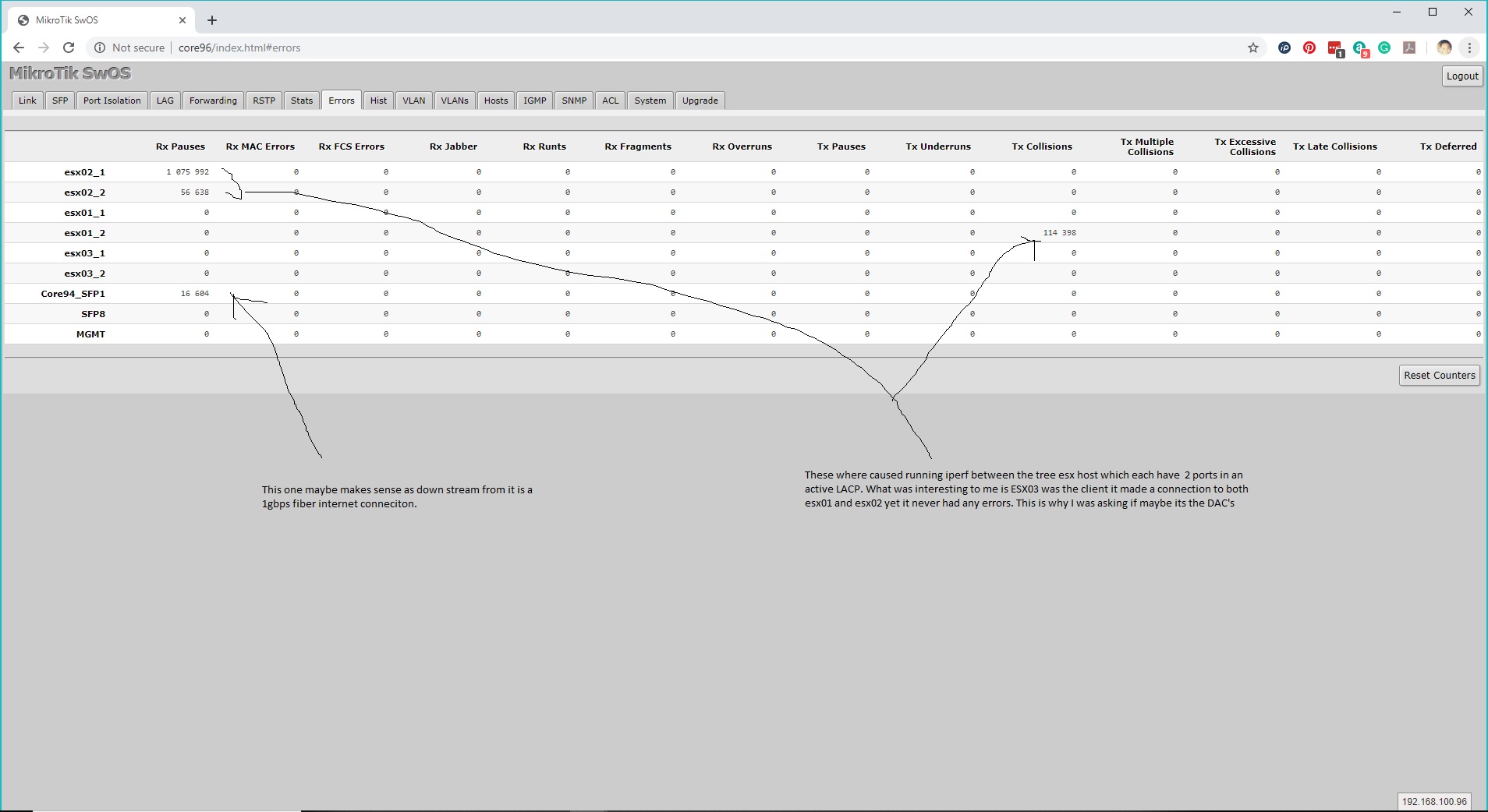

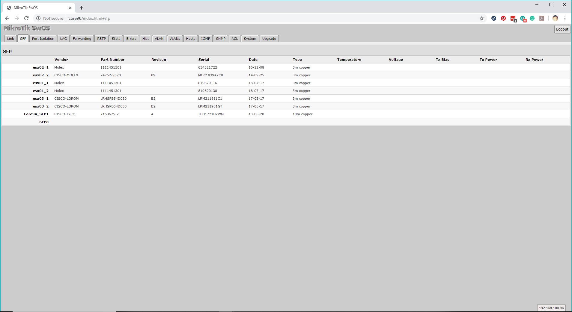

I have this same issue 2.10 I am wondering if anyone can say if they have this issue using Mikrotik SFP+ transceiver and any brand of fiber. I am starting to wonder if its a DAC issue. I can see this between my CSS3266-24G-2S+RM and my CRS309-1G-8S+ using a 10m Cisco active Twinax, as well as between my CRS309-1G-8S+ and my ESX host where there is like for like bandwidth and like for like a machine. When pushing 5gbps+ between ESX host that each have 2 10G i interfaces in an active LACP bond between them and the CRS309-1G-8S+, with 3m cisco Twinax.
Even pushing a solid 10gbps and getting this pause incrementing like my utility meter its not a huge impact on latency or bandwidth, but it is a problem if you had more sensitive setup than my home lab.
very rare
with 2.10 solved the issue on most scenarios
This is why I am wondering if its the DAC’s. On the interface labeled Core94 I can get seeing this type of error as its a 10g link that downstream has to exit 1g link either to a lan device or the fiber internet. However on the esx it doesn’t make much sense they each have bonded 10g pairs and I can see in the stats its load balancing pretty well for tx no so well for rx, to generate these errors here I ran a iperf for 3 minutes from esx03 to esx01 and a second iperf from esx03 to esx02. Its very interesting the esx03 got no errors while the other two host got errors, again leading me to ask of three identical network cards, going to the same switch what is different and the only thing is the dac’s.
I honestly can say for my current needs its more of a visual issue seeing the errors than an actual issue I notice. But at the same time if swapping out dac’s for optical would actually solve the problem then thats what I might have to do.
edit: On closer inspection I would expect it to be TX pause not RX pause on the core94 since its was generated running iperf to my colo so sending from a device behind this switch to an internet location limited to 1g
