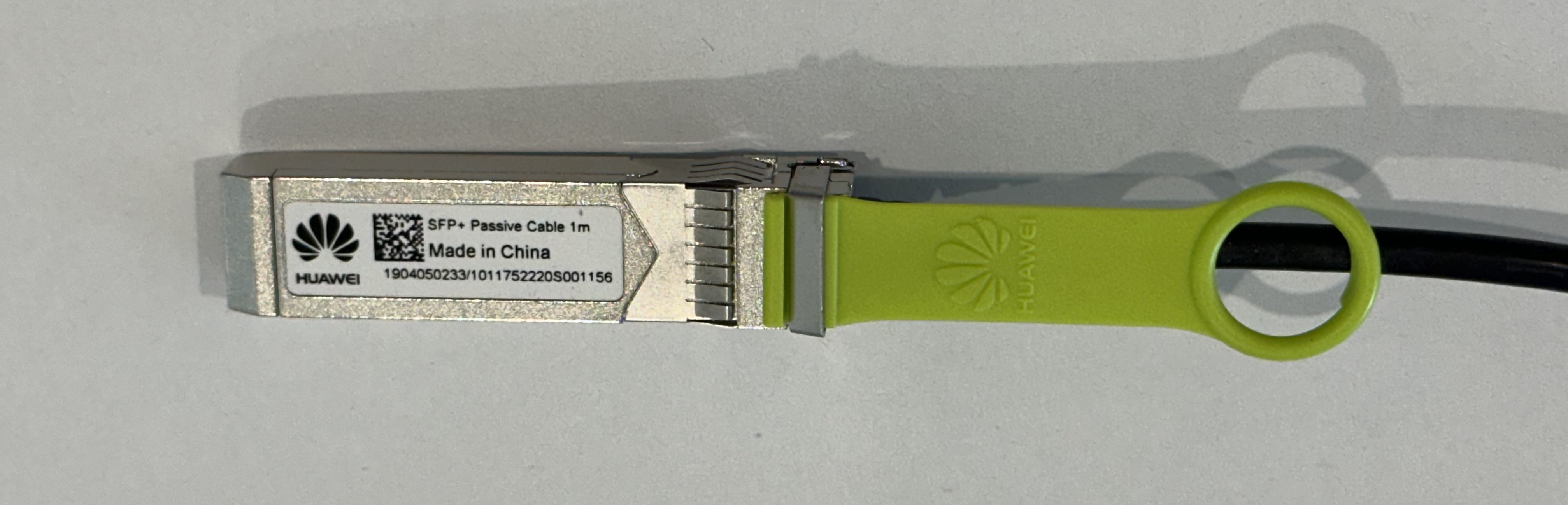

This is the 1mt DAC cable: https://ibin.co/90r1yRG2NkQy.jpg
