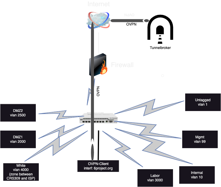

What I want to achieve is that I have all ipv6 traffic running through the tunnelbroker and ipv4 through the ISPs router.
On a vlan (2500) want to get ipv6 addresses for the clients.
There are limitations which lead to the actual intended solution. The ISPs does not provide any ipv6 support and is not able to route any. So only ipv4 traffic.
There is no possible way to use the ISP router as bridge. The "so called"public ip address is not reachable from outside. Even if it is in an public and not a private address (No Ping).
The openvpn-client is configured and seems to work somehow.
-I get an ipv6 address on the interface.2a05:AAAA:BBBB:CCCC:DDDD::2 and is pingable
-I know the gateway address 2a05:AAAA:BBBB:CCCC:DDDD::1 which is not pingable
-Packets are exchanged in the tunnel visible in the openvpn status.

I tried to make a more comprehensible picture.
