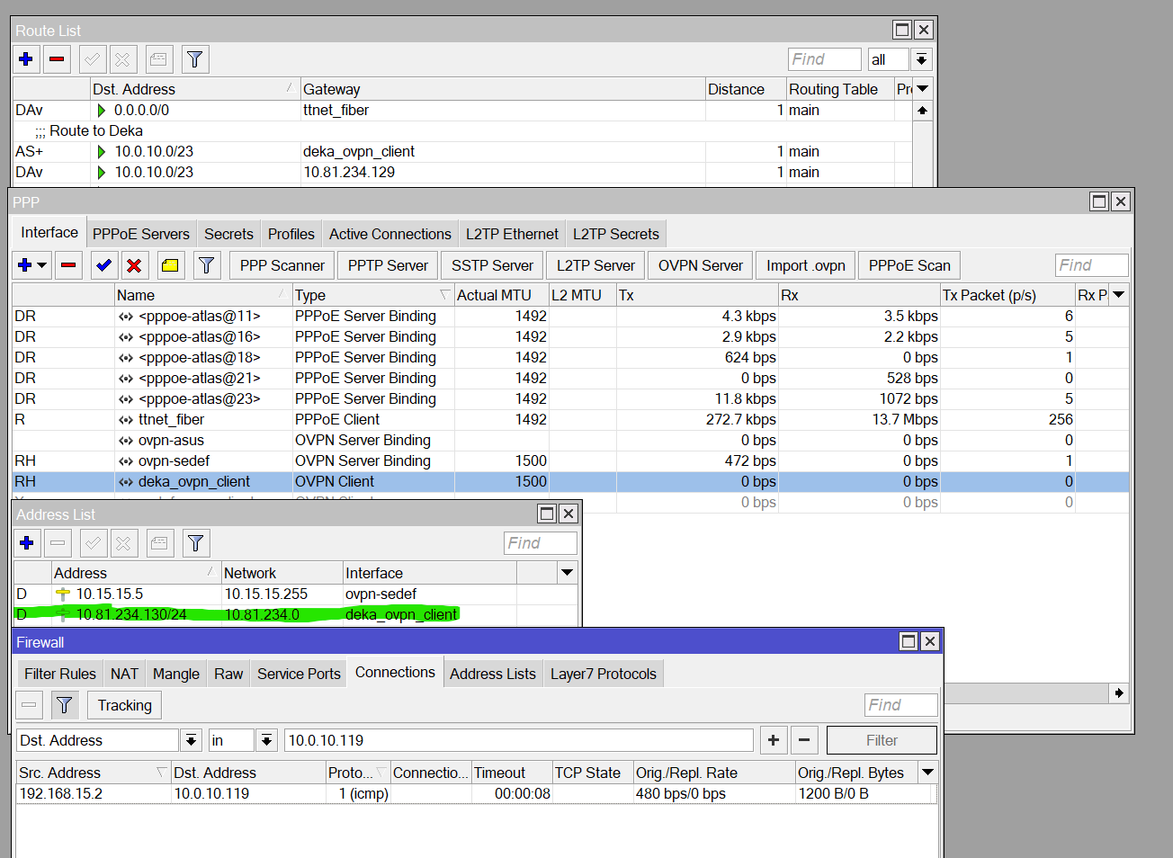

i did not understand exactly.
i have local IP from remote ovpn server it seen attached SS, and also ping successful for this ip(10.81.234.130). But I can not ping a local ip inside the remote network.

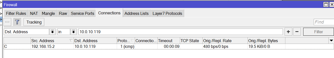

When i sniff the ping package it goes my ovpn interface transmissions are successful. But no reply.

On the Mikrotik can you ping 10.81.234.129?
On the Mikrotik can you trace route to 10.0.10.119, do you see the intermediate hops?
If so, perhaps 10.0.10.119 doesn’t respond to pings (from non local subnet)?
Could you ping this IP when connected via your computer?
You could add openvpn to system/logging for a while and see if the extra logs give any hints.

Thanks for your answer,
i can’t ping 10.81.234.129 it is OVPN remote ip
trace route does not reply any hop
i can ping 10.81.234.129 from 10.0.10.119 pc but can’t ping 10.81.234.130
I said that the ovpn-server did not respond, but I guess it is not transmitted at all. Because I cannot ping the local address of the ovpn-server too.
