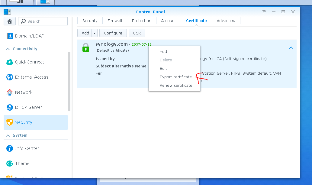

Hi, I’m trying to do the same. How did you configure the certificate ? What part of it did you import ?
I imported the ca cert with the private key exported from the nas (I don’t know why private key is required🤔)
Yes, But how did you do that. I’m trying to but with no success.
You may export here. And import the CA pem files including the cert and key in RouterOS
