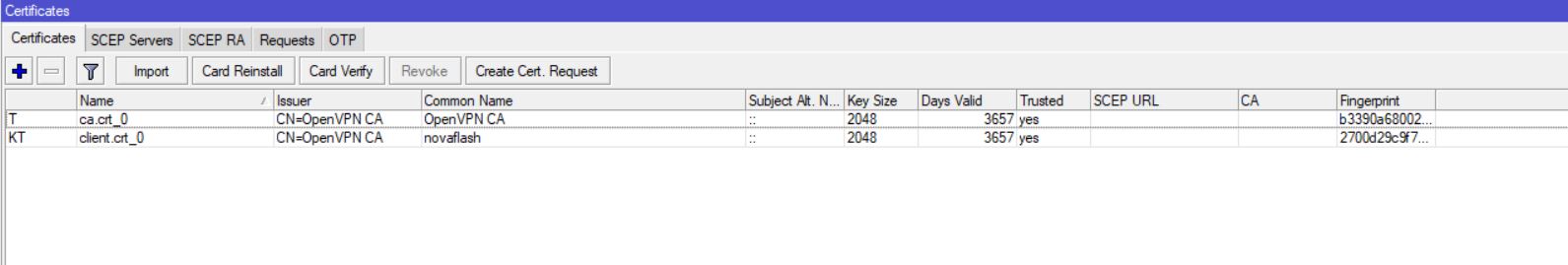

Im trying to setting OVPN Client on Mikrotik.
I have done steps for catching the certs. https://docs.openvpn.net/administration-guide/cli-command-line-interface/extracting-separate-certificate-files-for-a-user/
1- I downloaded the certs .

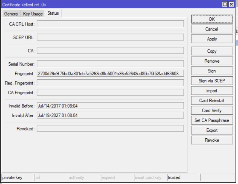

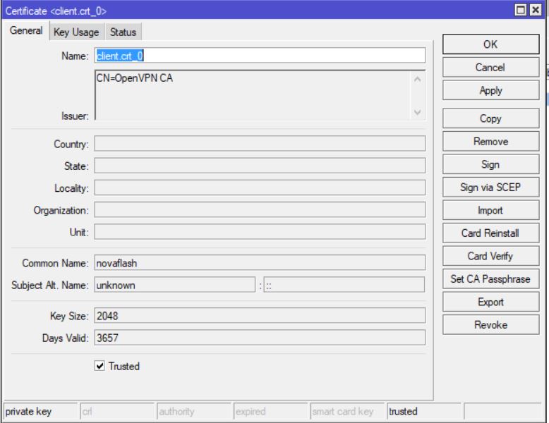

2. I have installed Ca and client.cert + client.key

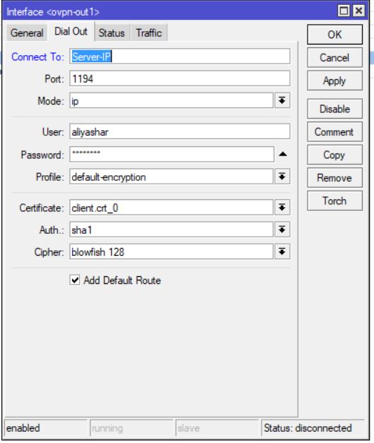

4. I have created an OVPN Client , assigned the client.cert
I cant connect to AS , did I miss any thing ?
I have attached print screens. kindly check it out .

MikroTik’s implementation is not native OpenVPN code. They don’t support things like UDP so if you are using a proper Linux OpenVPN server you may have to alter features to get it to work. I personally don’t use it myself so I can’t speak to much more on it.

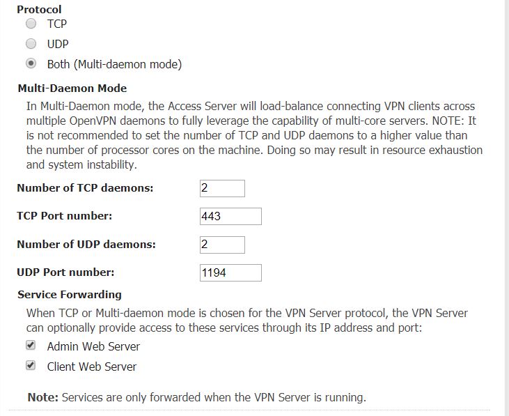

thank you for replying, as I checked AS covers UDP and TCP protocols.
Then isn’t the tcp vpn server running on port 443 instead of 1194?
Hey Rechard ,
Yes , you are right . I found out later when I posted. as I searched its not possible OVPN Client via Access Server right now. I have to change the solution SSTP or IPSec tunnel.
