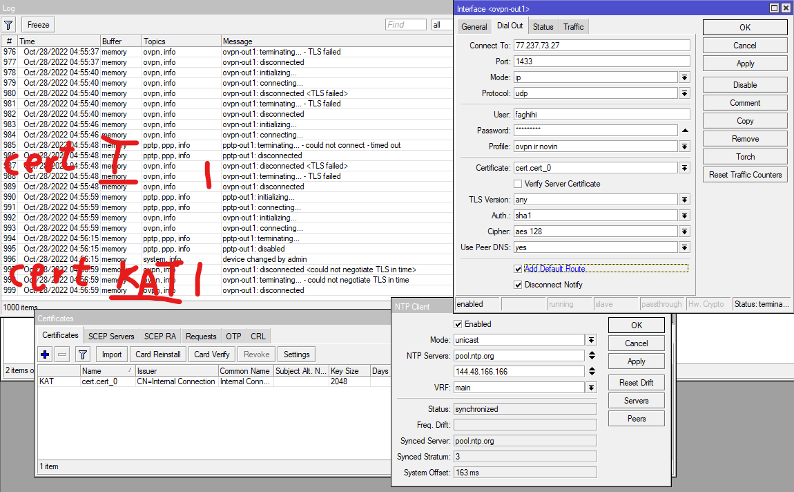

The cert contained the code: KAT
EDIT:
An hour ago I update to 7.6rc3
and I noticed the improvement in certificate management
So I delete the certificate, and tried to reimport... it didn't create the certificate for it...

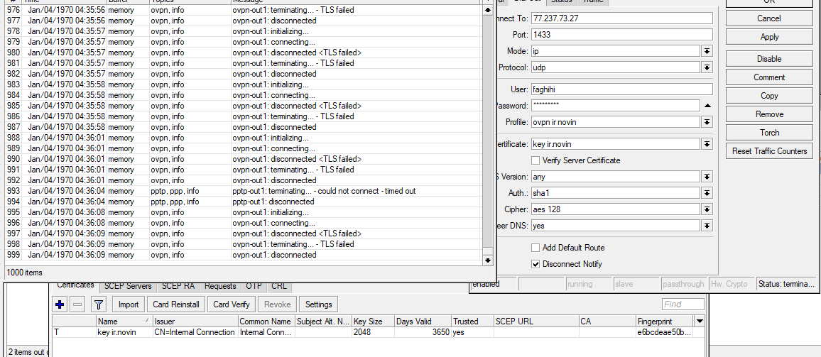

You have three things (two certificates and one key):
- certificate of CA (certificate authority) that issues other certificates, you need this for Verify Server Certificate option to work
- your client certificate, this is presented to server, so that it can verify that you have access; this is the one that you must select in OVPN client; did you do this?
- key for your certificate

i noticed the value of cert and ca are same in *.ovpn file… but the file it self in windows works

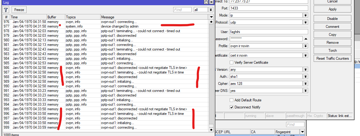

You have wrong time in router, it thinks that it’s 1970, it matters for TLS.
Shoud i configure NTP if im not wrong?
Well, something somewhere is still wrong. But config looks correct. You can try more detailed logging:
/system logging
add topics=ovpn
But I wouldn’t expect much useful/understandable info.
Well, it doesn’t seem understandable at all to me
[ LOG FILE REMOVED DUE TO SECURITY REASON ]
It makes two of us. I’m afraid I’m running out of ideas. The only unusual thing is that one certificate for everything, but if it works in Windows…
