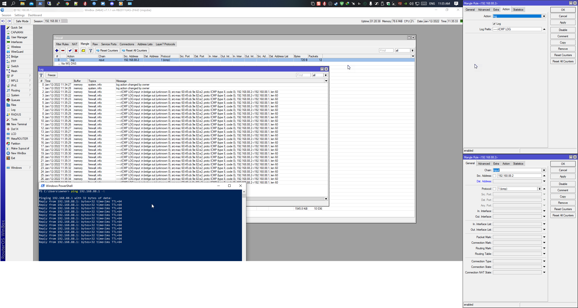

I have enabled the logging on the following firewall filter rule:
/ip firewall filter add action=accept chain=input comment="defconf: accept ICMP" protocol=icmp
However when I try to ping 192.168.22.1 from the router I get timeouts and only the outgoing traffic on the NAT is logged.
NAT srcnat: in:(unknown 0) out:ovpn-out1, proto ICMP (type 8, code 0), 192.168.22.2->192.168.22.1, len 56
No responses are logged. So the next important question is, how can I log the incoming ping responses? I know that 192.168.22.1 respons to ping as when I connect with another device and ping, it responds.
IP Firewall Mangel Mark an incoming connection with action= log and log prefix.
 chain=input action=log src-address-list=<list of remote LAN addresses to filter out all the WAN noise> log=yes log-prefix="mark"
None logs from this mangle rule.
