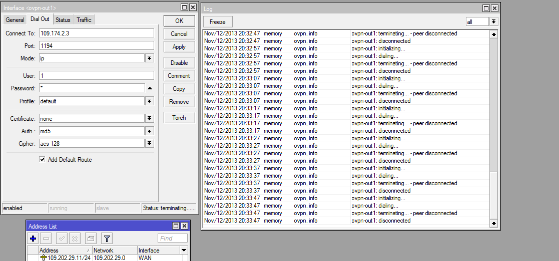

Because of so many changes in Certificates from version 6.4, I want to know how I can make OVPN work in ROS 6.6?

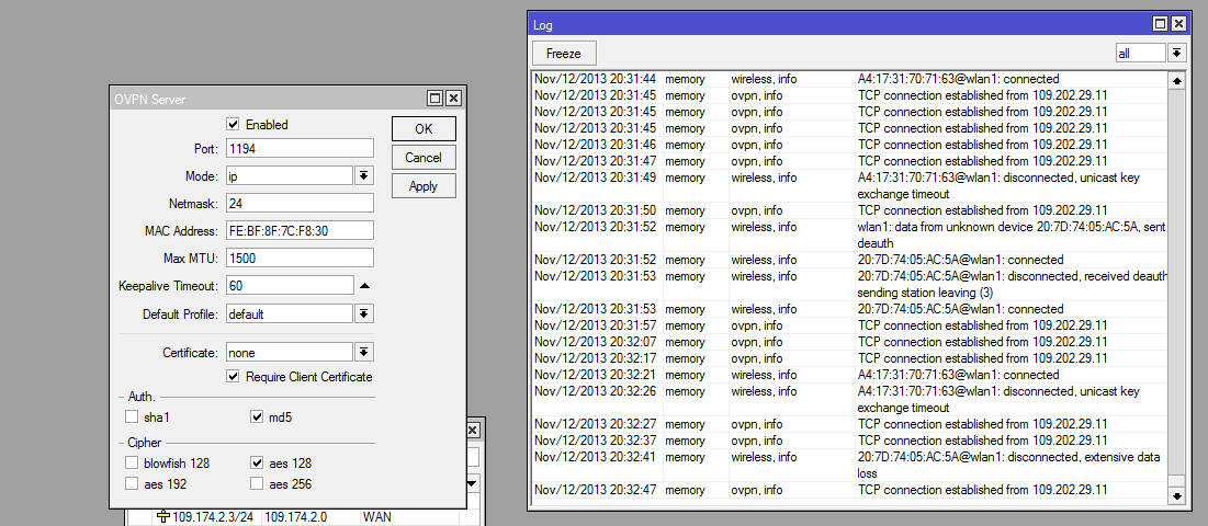

In WinBox->System->Certificates I’ve added certificate, but nothing good… when I trying to connect to OVPN server from other Mikrotik, that says to me “terminating…” and it’s all. If choose Certificate:none in OVPN Server setting, I have the same problem. Firewall disabled, secrets checked… and it worked on 6.3, but not on 6.6.

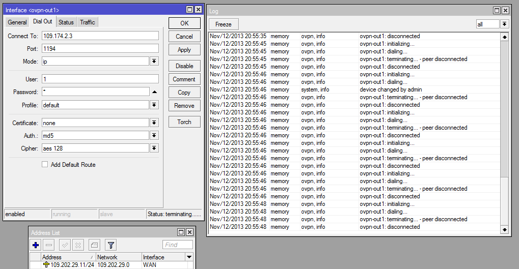

UPD: Well, I shoud correct something: ovpn doesn’t work on two simple Mikrotik’s with 6.6 ROS.
See screens.

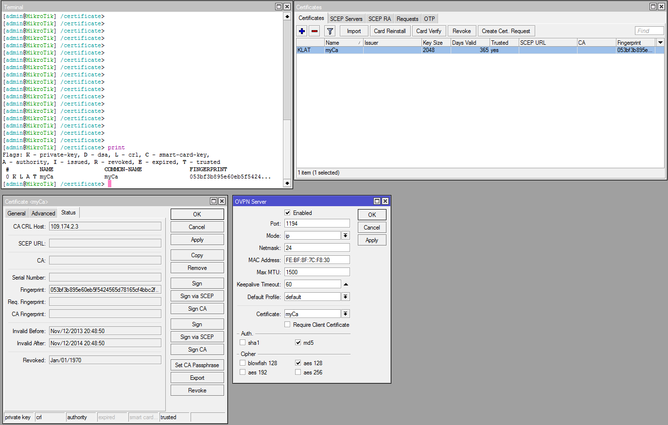

You do not have any certificates, in ovpn config certificate is set to none.
You can follow this guide to create certificates on RouterOS
http://wiki.mikrotik.com/wiki/Manual:IP/IPsec#Creating_Certificates
or import any externally created certificates
Thanks, mrz.
Done.
But ovpn-client is still “terminating…”

Add in logging OpenVpn to see what happens.
I use OpenVPN between two MT 6.6 and working also use from Windows client to MT 6.6 is working.
Some time happens OpenVPN server just stop working, client don’t what to connect reboot router work again. Try to reset router where is OpenVPN server, I have this situation with couple routers after reset client connect.
Thanks a lot, npero!
I’ve reboot MT with ovpn-server and now it works fine, clients are connected. Thank you!
