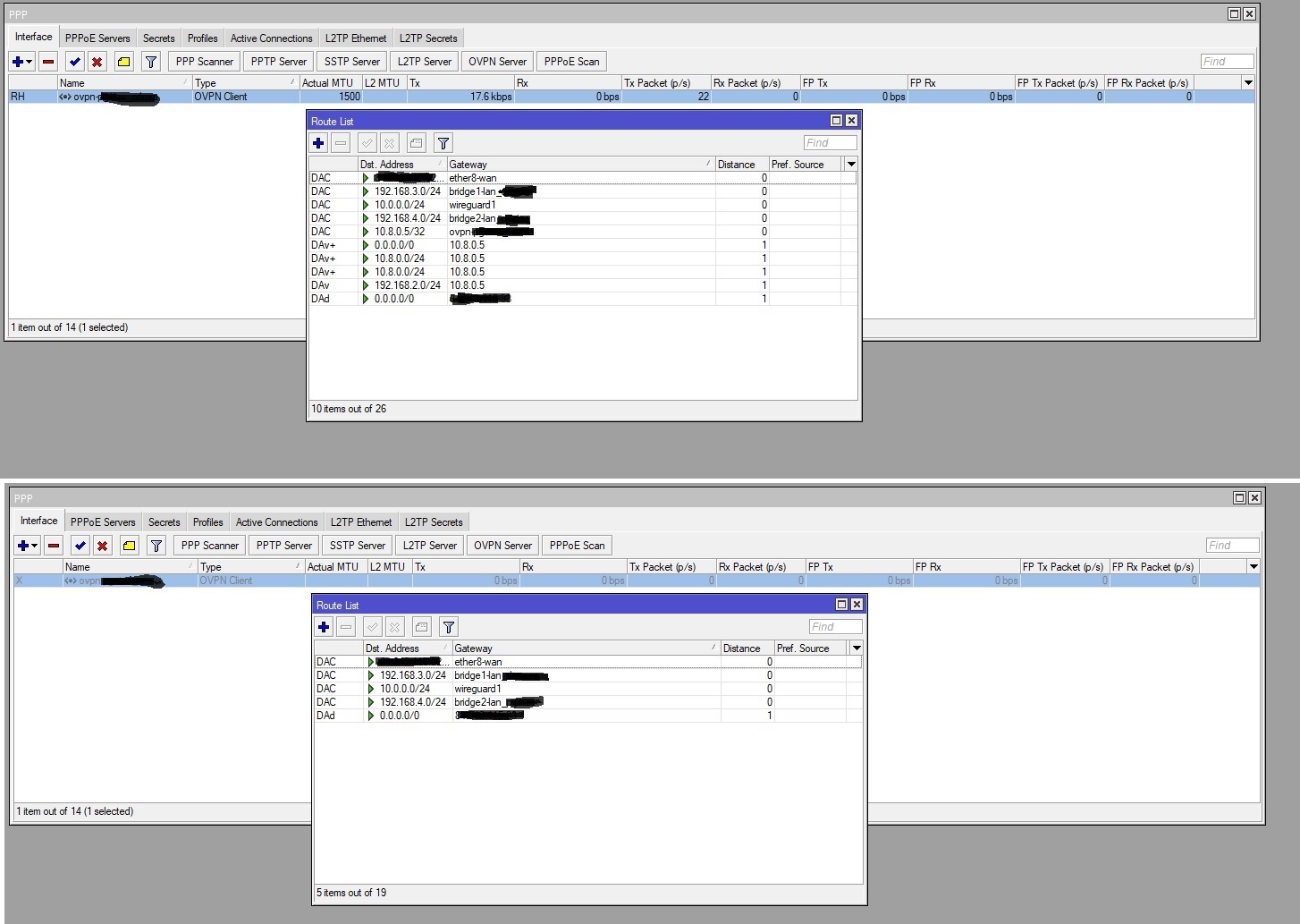

Hi, i am not sure, because if i enable my VPN client on mikrotik, Route List is updated automatically, which is something i dont really want/can influence, so unfortunately i have 2 issues:
  • it starts routing of all traffic to VPN (0.0.0.0 → 10.8.0.5) - this i dont want, i want route only remote network traffic (to 192.168.2.0/24)
  • anyway remote network is not accessible, the traceroute ends on local address of mikrotik (192.168.4.1) and does not continue to remote (10.8.0.5, 192.168.2.*)
You can see on my screenshots situation, when VPN client is enabled/connected or disabled. The change in routing list is done automatically, i do not make any manual change

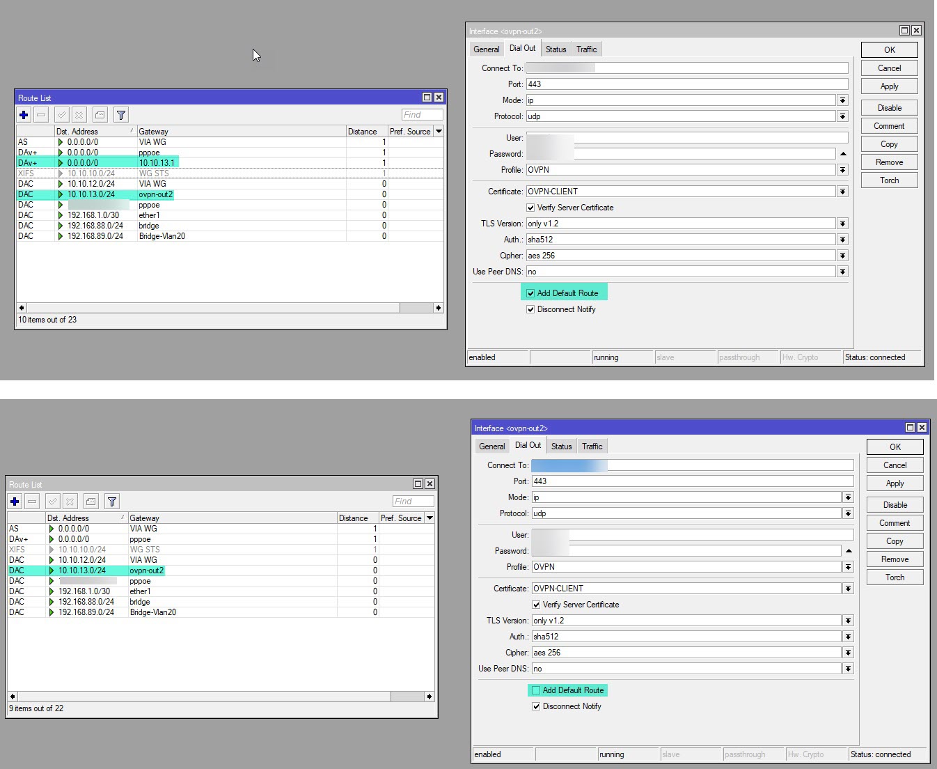

disable the default route if you don’t wish to route 0.0.0.0/0.

I can see the routes but I do not know how they came to be.
i can disable, true, i tried, but if connection is reconnected, its back again.
The ovpn connection i tried both, with or withoutch checkbox, but it does not make reall difference, the remote network is not available.

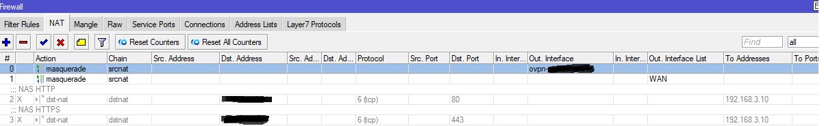

well, i have masquerading done in Firewall, this should not be the problem.
