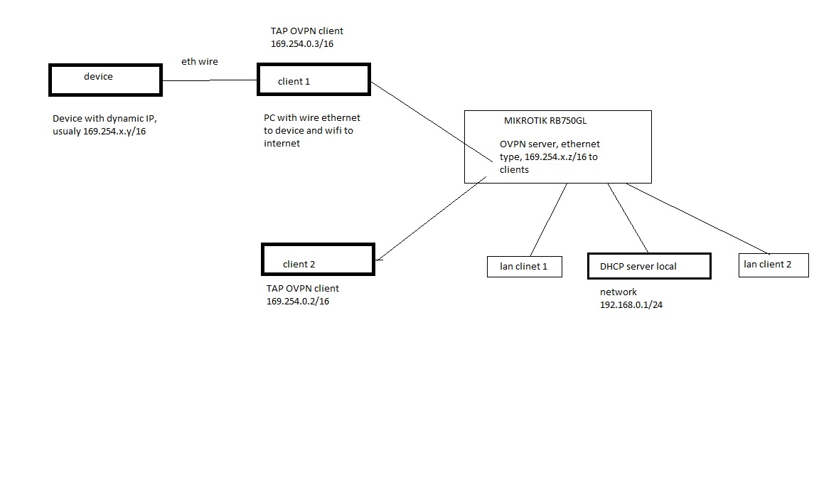

In my home network I have an TP-Link for internet access and local network DHCP server. Also an Mikrotik RB750GL, witch I want to use it for OVPN server.
I managed to set up OVPN server, for TAP interfaces, using IP from 169.254.0.0/16, because I have to access some devices with has dynamic IP adrdresses from same 169.254.0.0/16. The things stays like this : on laptop connected with wire to that device, and wifi to internet, OVPN TAP interface to my OVPN server. Laptop wired interface and OVPN TAP interfaces are bridged together . From an inside my home network I’m connecting to OVPN server also, both inside and outside computers can ping each others on 169.254.x.y/16 IP set by OVPN server. The problem is that laptop outside my network can ping device as long as VPN is not up, when I rise the VPN connection, laptop lose connection with device. Also from tests with other devices I saw that an wired device to outside laptop takes IP from my internal DHCP server, and that is not what I want.
Is there a way to block DHCP over VPN connections? I need TAP connection not TUN, because I have to be layer 2 with external device connected to external laptop.
I will attach also an picture with network diagram, maybe it will be easy to understand my problem.
For the start I think I need to block local DHCP server to be access by OVPN clients, and I don’t know how to do that.
