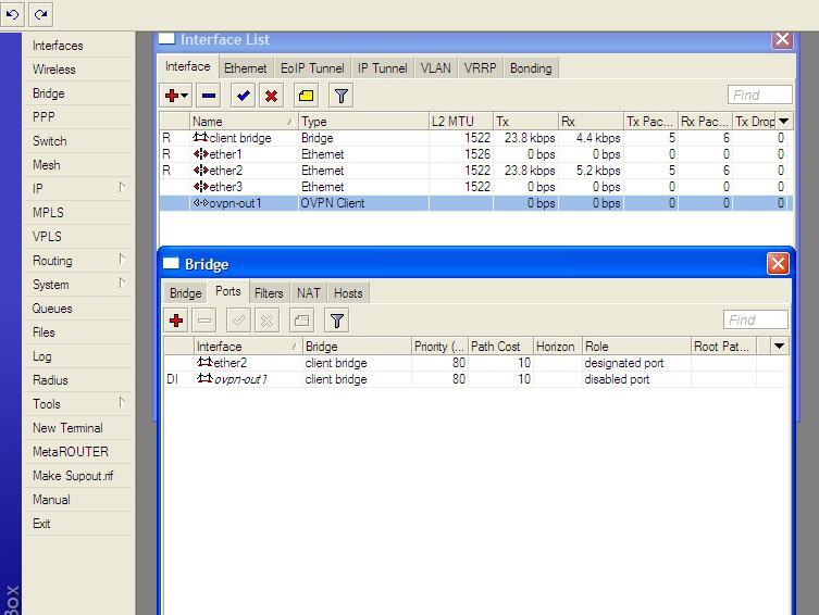

Hi, this is my first post here. I am trying to setup a ovpn solution. I have followed the wiki, generated the certificates, configured the server side, but now I am stuck here configuring the client side:
When I enable the ovpn-out1 on the interface, i get “disabled port” under bridge
Any ideas? :frowning:
It shows as disabled port, because OVPN is not connected. Enable ovpn logs and check error messages, to know why it is not connecting
Shows connected in the log file of “client” side. On “server” side it shows the ovpn connected!!!
Not sure where to look next.
