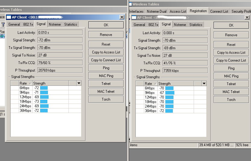

I have one PTP link (OS 4.11 + nstreme) and it does not have a clear fresnel zone clearance hence poor CCQ, but what i found there is a hugh difference between the P Throughput reading at the AP Bridge side and Station mode side of the link,(see screen shot)
Ap bridge side = 7359kbps , Station side = 20769kbps, would have thought that a misaligned link or fresnel issues or both would give a lower than max throughput on the link but this would equal when monitoring from each end? :confused:

One reason for the possible P-throughput value of 20,769 kbps on one radio and P-throughput value of 7,359 kbps could be that the 7,359 kbps radio is connecting at a lower modulation speed rate (6 Mbps) and the 20,769 kbps radio is talking at a faster modulated rate (35 Mbps).
OK but strange i tried two different units on the AP side of the PtP link and both which were a short distance (approx 50 meters ) apart but also had fresnel issues gave lower throughput than from station side?

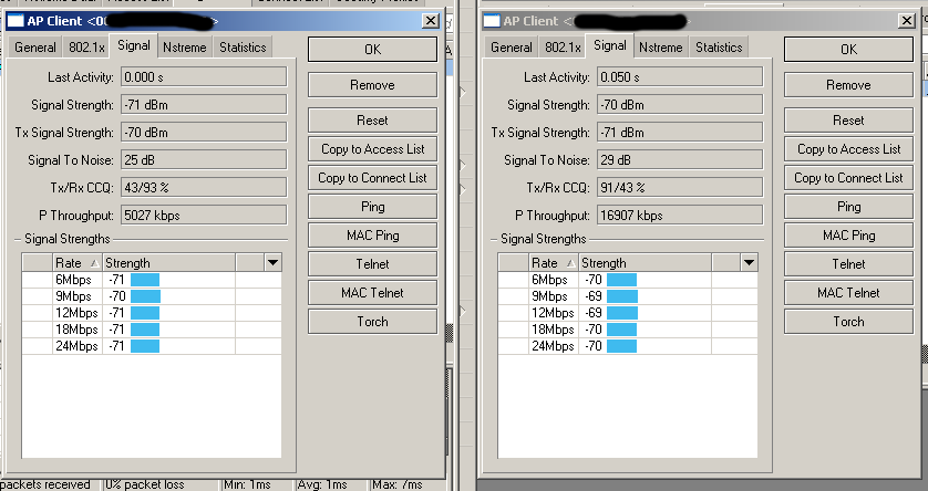

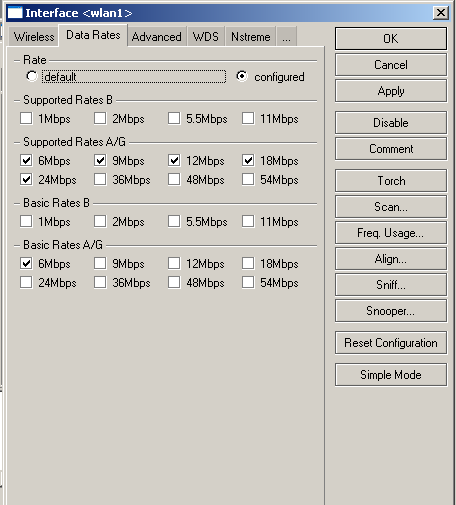

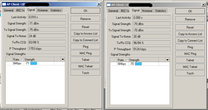

Attached (1) datarates at 24Mbps just to show is my config correct for this, (2) at 24Mbps AP is on the left, (3) at 6Mbps AP is on the left

Applying these tweaks did not improve throughput but did make the wireless association (R) much faster on dude on both 6 and 24Mbps datarates and quicker to log into units at the other end of the link,
