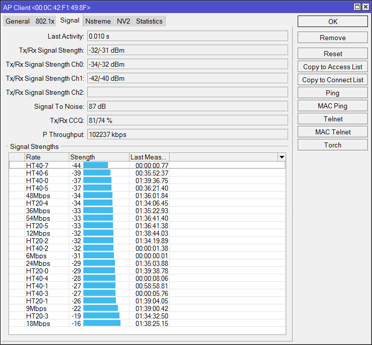

You have to lower transmitting power on your devices.
Signal strenght should be -60 to -50 dBm for best results.
HTH,

I have lowered on both my AccessPoints the power:
local AccessPoint:
set wlan1 manual-tx-powers="1Mbps:7,2Mbps:7,5.5Mbps:7,11Mbps:7,6Mbps:7,9Mbps:7
,12Mbps:7,18Mbps:7,24Mbps:7,36Mbps:7,48Mbps:7,54Mbps:7,HT20-0:7,HT20-1:7,H
T20-2:7,HT20-3:7,HT20-4:7,HT20-5:7,HT20-6:7,HT20-7:7,HT40-0:7,HT40-1:7,HT4
0-2:7,HT40-3:7,HT40-4:7,HT40-5:7,HT40-6:7,HT40-7:7"Remote Accesspoint:
set wlan2 manual-tx-powers="1Mbps:6,2Mbps:6,5.5Mbps:6,11Mbps:6,6Mbps:6,9Mbps:6
,12Mbps:6,18Mbps:6,24Mbps:6,36Mbps:6,48Mbps:6,54Mbps:6,HT20-0:6,HT20-1:6,H
T20-2:6,HT20-3:6,HT20-4:6,HT20-5:6,HT20-6:6,HT20-7:6,HT40-0:6,HT40-1:6,HT4
0-2:6,HT40-3:6,HT40-4:6,HT40-5:6,HT40-6:6,HT40-7:6"I’m a little bit scared of lowering it to a lower value. Because i’m doing it remote. So if it set it to low, and I don’t have a connection anymore, i have a big issue.

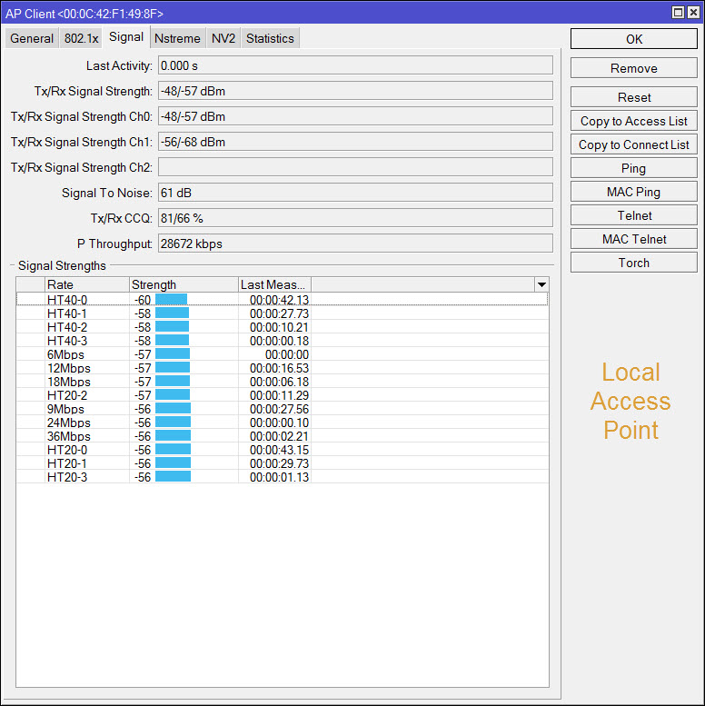

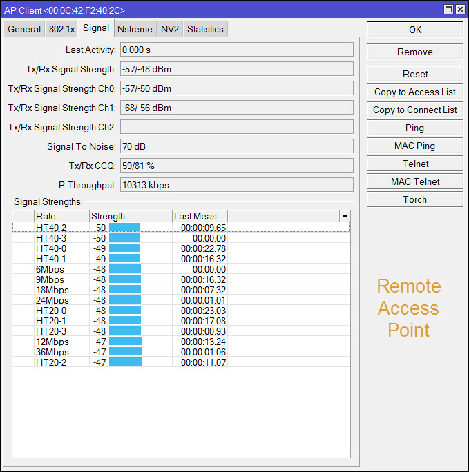

I see some improvements. The strengt is a lot more stable and better if I understand you advice correctly.
But still the remote access point link is very unstable. I notice now even more disconnects of the wifi link. So in a way, its even more unstable. It link yes to be run sometimes for yours. Now its disconnecing every few minutes.

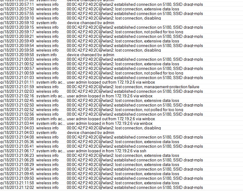

The Log File
21:06:25 wireless,info 00:0C:42:F1:49:8F@wlan1: disconnected, too many poll timeouts
21:06:28 wireless,debug wlan1: 00:0C:42:F1:49:8F attempts to associate
21:06:28 wireless,debug wlan1: 00:0C:42:F1:49:8F not in local ACL, by default accept
21:06:28 wireless,info 00:0C:42:F1:49:8F@wlan1: connected
21:08:31 wireless,info 00:0C:42:F1:49:8F@wlan1: disconnected, too many poll timeouts
21:08:34 wireless,debug wlan1: 00:0C:42:F1:49:8F attempts to associate
21:08:34 wireless,debug wlan1: 00:0C:42:F1:49:8F not in local ACL, by default accept
21:08:34 wireless,info 00:0C:42:F1:49:8F@wlan1: connected
21:09:47 wireless,info 00:0C:42:F1:49:8F@wlan1: disconnected, too many poll timeouts
21:09:50 wireless,debug wlan1: 00:0C:42:F1:49:8F attempts to associate
21:09:50 wireless,debug wlan1: 00:0C:42:F1:49:8F not in local ACL, by default accept
21:09:50 wireless,info 00:0C:42:F1:49:8F@wlan1: connected
