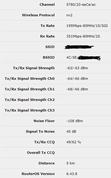

The stats for the existing link are attached in the image.
My question is would the LHG 5 ac be a good replacement for the existing radios and should I expect better throughput using nv2?
Currently the link is stable enough (odd few drops), but throughput can vary from 50Mb to 100Mbit TCP between devices each side.

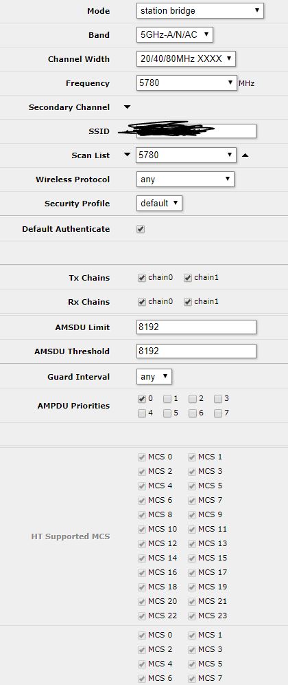

Link Config
No, all ARM Based Mikrotik had issue with Nv2
And they don’t Performe well.
In your case i would go with RF Elements TP-550 Dish, TPA-RBC Adapter , M11G, R11e-5HacD
With about 10dBi Better Antenna and quite good shielding you would archive much more speed (your ccq now is bad)
If the speed you get with the new Hardware is not enough anymore you could change to AF-5xHD
Only by exchange Radio and Adapter, the dishes are reusable…

The CCQ is what I would like to improve, which I think would then left improve bandwidth (I think), any suggestions that may help in the short term for this?
Would improving CCQ also by default help improve bandwidth?

Mikrotik integrated devices antennas work good for 5200-5700 above this frequency window
The antennas do not perform well
And yes a better ccq means higher Modulation and higher throughput…

Antenna a = 33dbm
Path loss 5780, 5.5km = -127,5 dB
Antenna b gain = 17 dBi
your Target with Receiver power should be -77 you Are about 10-15db to hot.
Looks like the person before not take care of law, this link was bad designed at the beginning
I agree about the previous person :grin:
So are you saying I should reduce the power of the radios if their 10-15db to hot?
There on default power settings at the minute but this can be changed I assumed?
With 15db reduce you are near the point the link begins dropping because of to low signal
