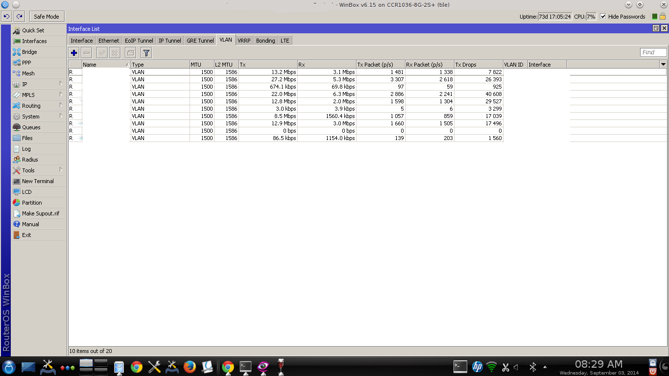

hi,
I’m getting vlans packet drops on ccr 1036-8g version 6.15. I’d sent the support file. Had anyone experienced this kind of problem ? Scared to upgrade to 6.19 :frowning:

thanks, I’m not using any queue with hw queue. All the queues are default-small. Now changed to ethernet-default with pfifo queue size to 500 packets but packets are still dropping

which version r u using ? I’ll reboot later on. Queue size 500 is already too big for small bandwidths. Wrong screenshot posted earlier :stuck_out_tongue:
