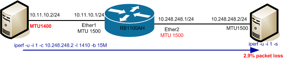

Attached scheme is my simulation setup - just 2 PCs connected to 2 ports of RB1100AH.
I intentionally decreased the MTU of first PC in order to send fragmented packets.
Test is performed with iperf as described in the picture and the result is 2,9% packet loss.

Maybe I’m wrong.. but this way your PC is not sending fragmented packets, but receiving them.
PC1 sends 1400 byte frames to RB, which is fine, because RB has a higher MTU.
Traffic that’s coming back has 1500byte frame size, which is too large for PC1, because it only accepts frames up to 1400 byte size.
You should decrease the MTU to 1400 on de ether1 interface of the RB. That way the RB can construct neat 1400 byte frames for PC1, instead of letting PC1 just cut off the last 100 bytes of the 1500 bytes frames.
Thanks onnoossendrijver
Unfortunately this is not the problem.
The last my post is just simulation in order to find real reason. The traffic here is one way UDP from PC1(left one) that is verified in PC2(right). Packets from PC1 is sent fragmented because the sum of payload +headers exceeds the MTU of interface. The same sum is small enough to be passed through ether2 of RB1100 and it tries to assemble the packets. After this process we get 2,9% lost packets in PC2. For sure packet loss is happened in RB because I gathered pcap files in both interfaces of RB and following UDP stream I see the difference.
I understand your problem now. Unfortunately I don’t have an explanation.
