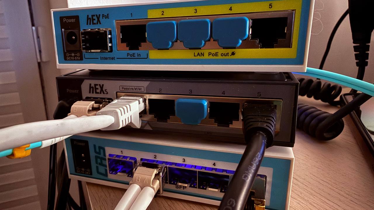

I'm troubleshooting an issue in a client’s network and decided to reproduce it in a lab setup.
The problem seems to appear only when using the new hEX S Refresh model connected to a CRS106 via fiber.
Lab setup
Devices:
hEX S Refresh
CRS106-1C-5S (latest RouterOS and firmware)
Connection:
SFP fiber link between them
Config:
Both devices have a bridge with all ports added
Each bridge has a single IP in the same subnet
No VLANs, no firewall rules, no NAT — pure L2 bridge test

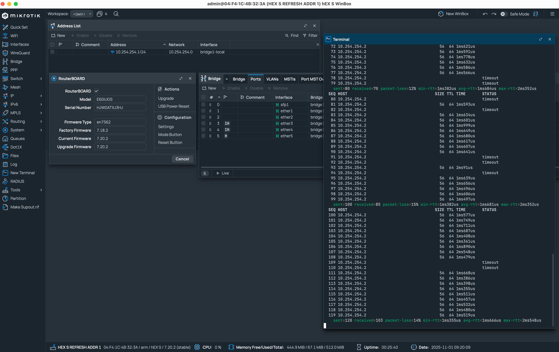

When pinging between the devices, I consistently get 1–2 ms latency (which is quite high for a local link) and frequent timeouts:
807 10.254.254.2 timeout
808 10.254.254.2 56 64 1ms649us
809 10.254.254.2 timeout
810 10.254.254.2 56 64 1ms629us
820 10.254.254.2 56 64 1ms694us
821 10.254.254.2 56 64 1ms613us
822 10.254.254.2 56 64 1ms816us
Packet loss starts small (around 5–10 %) but increases over a few minutes until pings almost constantly time out.
CPU load is low, temperature normal, and there’s no sign of a loop.
