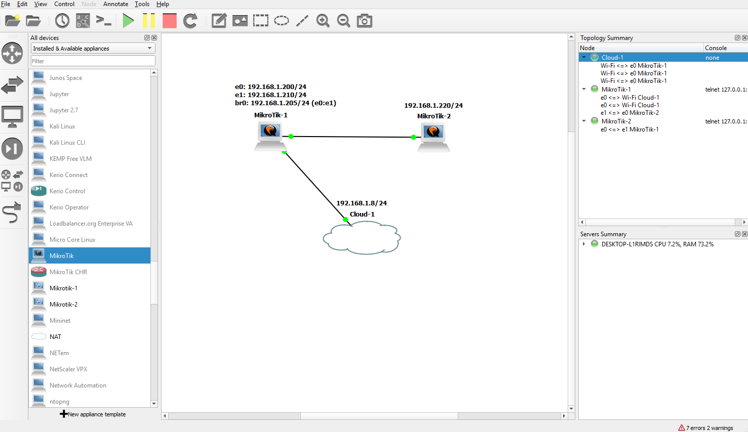

First post here and I am sorry if I post in wrong section. Starting to work with MikroTik and GNS3. I have issue as the picture below.
These guys can talk without issues to each other:
Cloud-1 < — > MikroTik-1
MikroTik-1 < — > MikroTik-2
But Cloud-1 have 50% packet loss to MikroTik-2 and MikroTik-2 have 100% packet loss to Cloud-1.
Thing that looks strange but maybe it’s normal is the Topology Summary, C1 → M1 got 3 connections (?) and M1 → C1 got 2.
Happy for any ideas in correct direction that might help me :slight_smile:
Thanks!
Hi
interfaces part of a bridge should not have ip’s on their own. ip should be defined on the level of bridge.
