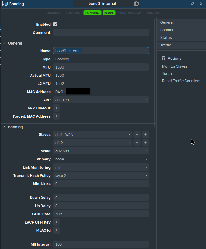

what type of 802.3ad / LACP bonding are you using ? ( balance-xor , balance-rr , active-backup , broadcast , balance-tlb ).
I myself prefer to use active-backup bonding ( one active and the second is fall-back ).
Some of the other above methods can be CPU intensive ( a CRS326 is not a CPU power house - it’s mostly a switch with some ARM-32bit 800-MHz CPU capabilities ).

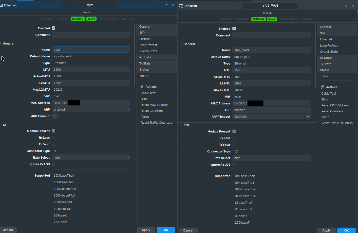

See attached screenshot. It’s just 802.3ad, this was specified by the upstream colo provider. They are using Arista gear and cal it “active/active”.
Links are over 10G fiber using FS transceivers https://www.fs.com/au/products/230697.html
I’m not seeing any Ethernet errors, no.

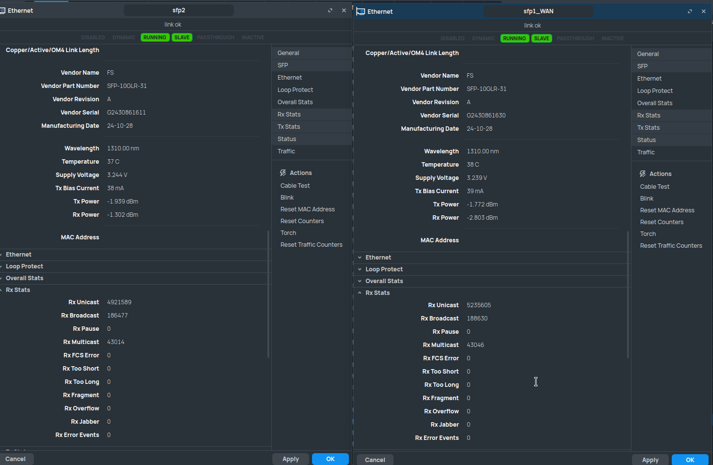

On your Mikrotik CRS , using Winbox
Click on Interfaces , then click on sfp interface , then click on the SFP tab.
Look at your Tx power and your Rx Power ( verify both sided of your links have a receive Rx-Power that is within spec of your fiber sfp+ module
also
Click on Interfaces , then click on sfp interface , then click Rx-Stats then Tx-Stats , do you see any errors there ? ( check both sides of the fiber links ).
And and look for anything else on that page that might not be normal.
Clear your counters and see what counters are growing.
Check MTU on both sides of your links.
Check your logs
edit - if you drop one of your interfaces then up it later then later drop the other interface, do the errors go away when ether interface was shut ?

I reviewed all your suggestions and I cannot see any issue. I have attached screenshots to confirm.
Thank you

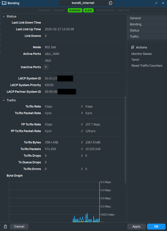

I meant the ethernet interface counters, at the switch:
from CLI:
/interface/etnernet/print stats
or for a more compact view:
interface/ethernet/print stats proplist=rx-too-short,rx-too-long,rx-pause,rx-error-events,rx-fcs-error,rx-fragment,rx-overflow,rx-jabber,tx-pause,tx-underrun,tx-collision,tx-late-collision,tx-drop
you can add “default-name” after tx-drop to show the interface names, but this might make reading more difficult, as with 26+ interfaces, there might not be enough space to fit the table in a single line
check for very high, or increasing TX-drop or RX-drop counters (relative to troughgput / total packets)
some drops are normal, but if during your test you see a huge increase in drops, then lack of available buffers might be the cause

@guipoletto, I ran the command you suggested, this is the output:
rx-too-short: 0 0 0 0 0 0 0 0 0 0 0 0 0 0 0 0 0 0 0 0 0 0 0 0 0 0
rx-too-long: 0 0 0 0 0 0 0 0 0 0 0 0 0 0 0 0 0 0 0 0 0 0 0 0 0 0
rx-pause: 0 0 0 0 0 0 0 0 0 0 0 0 0 0 0 0 0 0 0 0 0 0 0 0 0 0
rx-error-events: 0 0 0 0 0 0 0 0 0 0 0 0 0 0 0 0 0 0 0 0 0 0 0 0 0 0
rx-fcs-error: 0 0 0 0 0 0 0 0 0 0 0 0 0 0 0 0 0 0 0 0 0 0 0 0 0 0
rx-fragment: 0 0 0 0 0 0 0 0 0 0 0 0 0 0 0 0 0 0 0 0 0 0 0 0 0 0
rx-overflow: 0 0 0 0 0 0 0 0 0 0 0 0 0 0 0 0 0 0 0 0 0 0 0 0 0 0
rx-jabber: 0 0 0 0 0 0 0 0 0 0 0 0 0 0 0 0 0 0 0 0 0 0 0 0 0 0
tx-pause: 0 0 0 0 0 0 0 0 0 0 0 0 0 0 0 0 0 0 0 0 0 0 0 0 0 0
tx-underrun: 0 0 0 0 0 0 0 0 0 0 0 0 0 0 0 0 0 0 0 0 0 0 0 0 0 0
tx-collision: 0 0 0 0 0 0 0 0 0 0 0 0 0 0 0 0 0 0 0 0 0 0 0 0 0 0
tx-late-collision: 0 0 0 0 0 0 0 0 0 0 0 0 0 0 0 0 0 0 0 0 0 0 0 0 0 0
tx-drop: 0 0 0 0 0 0 0 0 0 0 0 0 0 0 0 0 0 0 0 0 0 0 0 0 0 0
The device uptime is 1d17h and I have been running mtr test for the last 8 hours.
