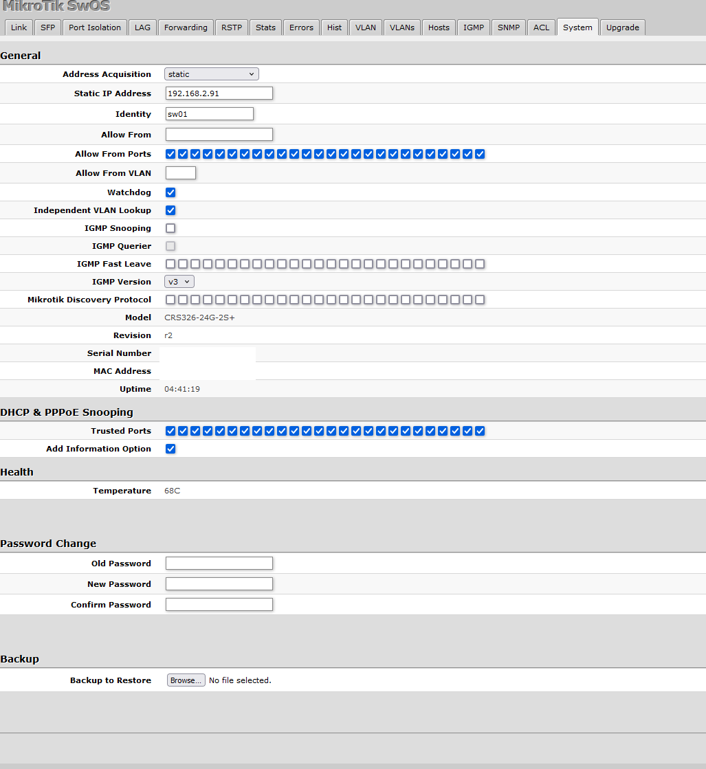

The SwOS version is 2.17 (the newest).

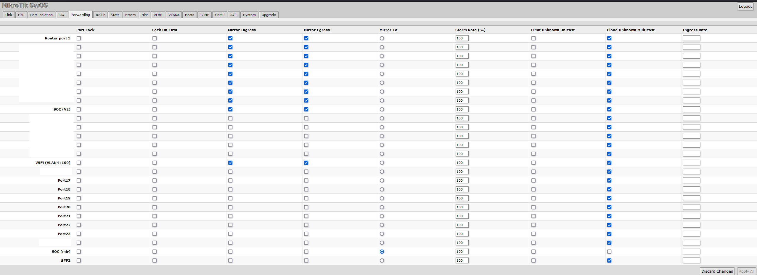

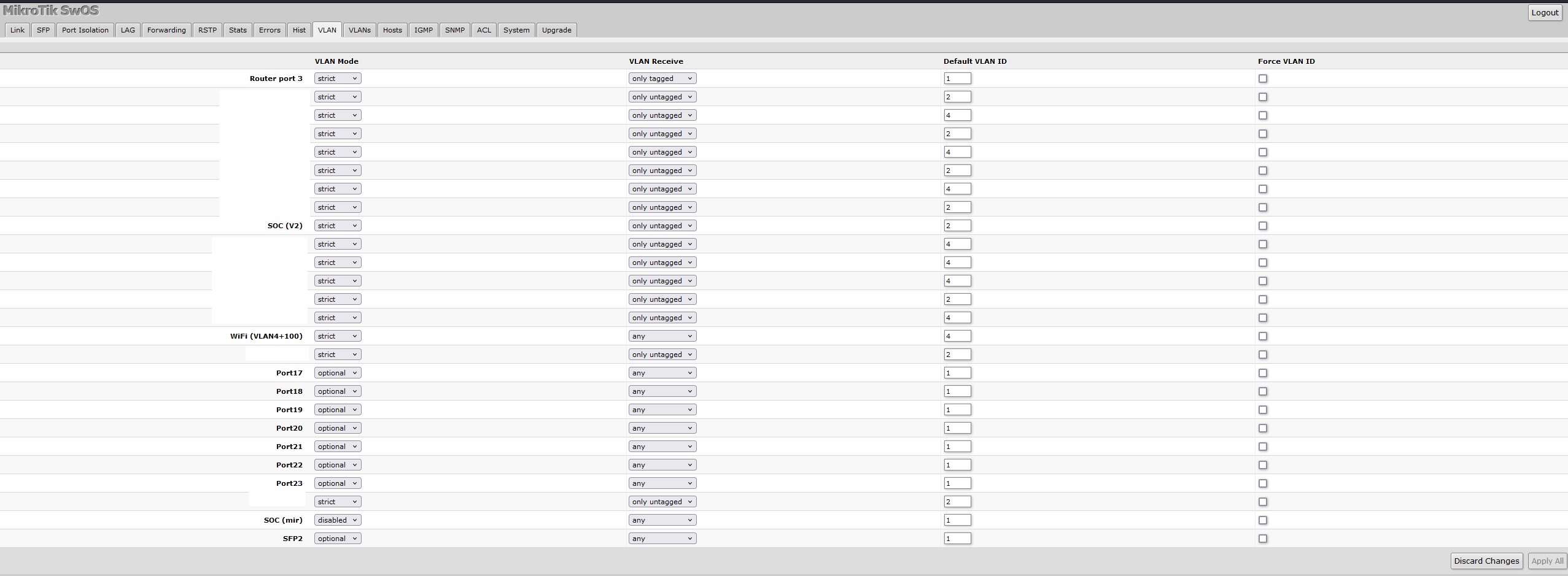

The switch is configured with these settings:
When I download with approx. 700 mbit/s from the Internet (the router is on port 1, and the client is on port 24), the packet loss on the mirror port is approx. 52% (it is mentioned as 52% capture loss in Securyonion). Because there are no Zeek Loss or Suricata Loss in Securityonion, the high packet loss is not due to Securityonion (https://docs.securityonion.net/en/2.4/grid.html#capture-loss). Even with low download speed (under 30 mbit/s), the packet loss is high (over 20%).
I have tried the following:
  • Limit the mirror ingress and mirror egress port in the Forwarding tab

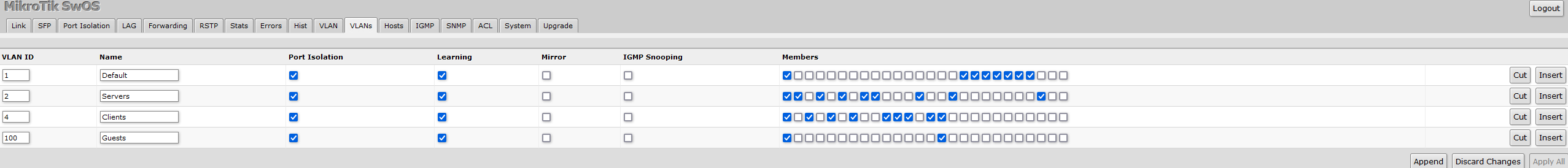

  • Disabled (unmark) mirror ingress and mirror egress on all ports in the Forwarding tab, and enabled (mark) “mirror” on all VLANs in the VLANs tab
I dont know how to move on from here, and what I may have done wrong in the configuration.
