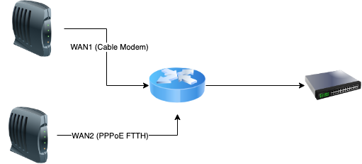

network diagram and config /export file=anynameyouwish ( minus router serial number, public WANIP info, keys etc.)
quick diagram of the layout… its very basic…
a (hopefully) cleaned copy of the export is attached too… thanks.
