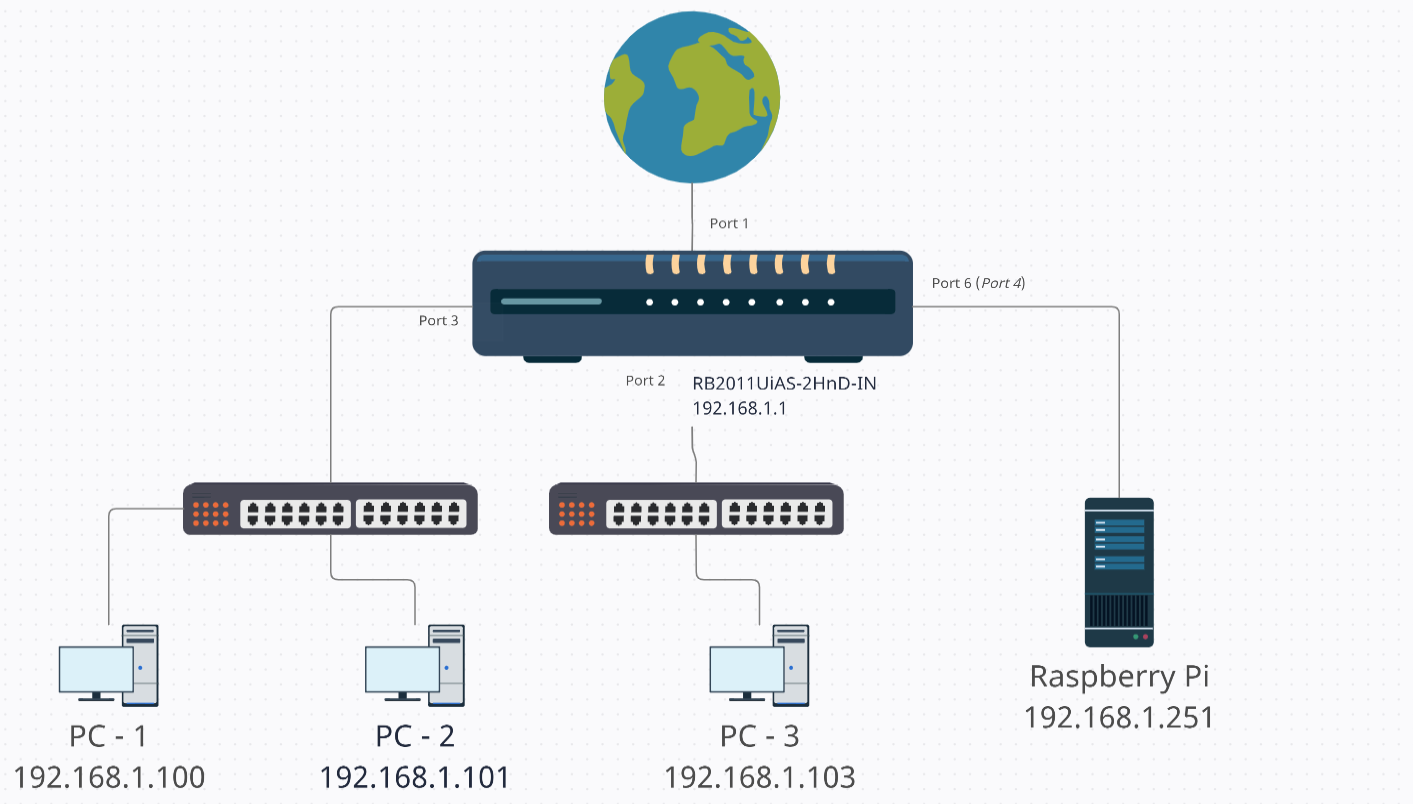

To your first point, this is my logic to check that it is not a cable, device or switch issue.
See network diagram
PC-1 to Router (Port 3) - Packet loss
PC-2 to Router (Port 3) - Packet loss
PC-2 to PC-1 - No packet loss
PC-3 to Router (Port 2) - Packet loss
Raspberry Pi to Router (Port 4) - Packet loss
Raspberry Pi to Router (Port 6) - No Packet loss
I think it shouldnt be a problem with my devices or cables.

Info: Any operation between 1-5 port to 6-10 port, and vice-versa go trough the CPU
Only between 1-5 and sfp port internal 1G switch are used
Only between 6-10 port internal 100M switch are used
All services go trough CPU and on this model do not expect performance.
When you ping the router, you ping the CPU,
when you ping between pc, all passtrough the switch chip without using CPU.

Thank you for the feedback on the config. I have made the changes and I am still seeing drop packets.
It definitely seems like any packet going to the Atheros chip on Port 1 - 5 is having packet drops in this case.
Are there any other config changes that might be able to resolve the issue? Or does this seem like a hardware issue?
