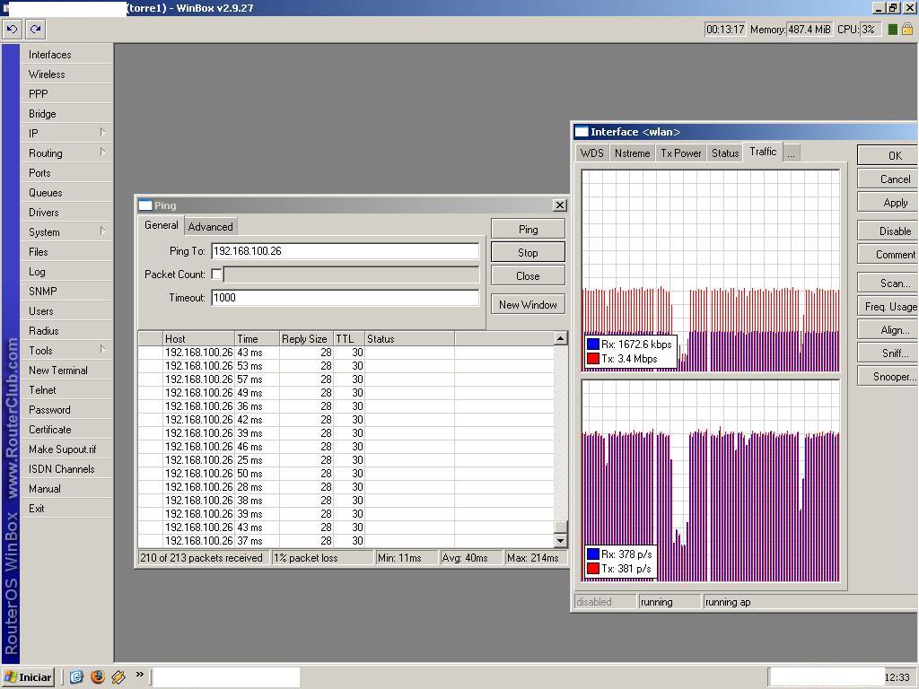

inlab test. brought my ap to the ground and tested it with just one pc connected on it by the wlan interface.
notice that the ping is <1ms if i stop the btest (no restrictions on up or dl) i was running on the client.

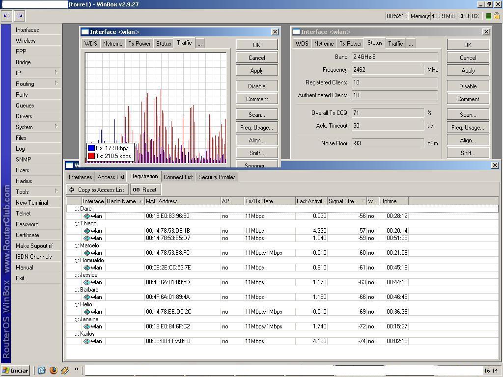

Here with the ap-bridge back onto the tower, i do some checking like the current traffic on the interface, amount of clients connected and timeouts:

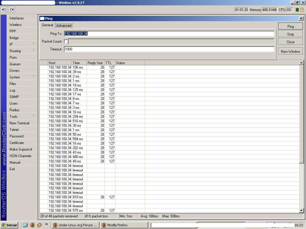

and right after take the screenshot i run ping tests on some clients:

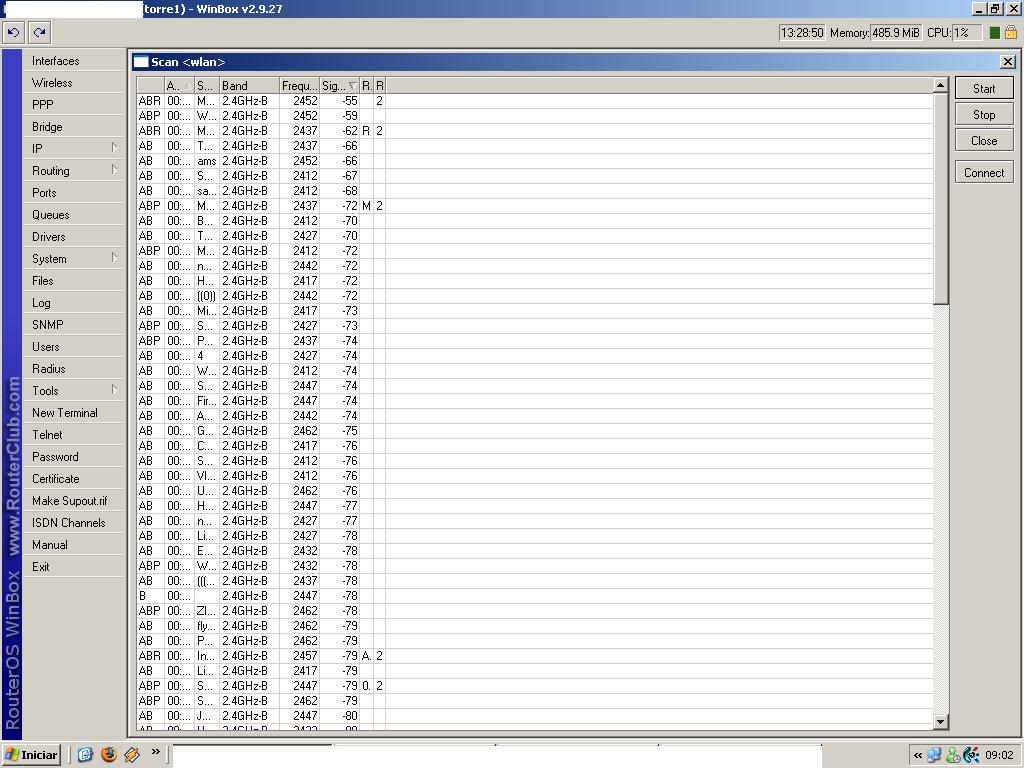

heres the survey´s screen:

Well, you can see quite a few networks, but I’d be most concerned with the first 5 or so that have really strong signals as they may be overloading your AP. It could also be at the client side too.
One thing to note: even with nearby AP’s on the same channel as you, they seem to play pretty well together. May slow things down but usually not knock connections all the way offline. Cordelss phones and other “non 802.11 stuff” usually does much more damage.

yea ive tried many different channels. At first (when that second stronger signal dont even existed) i was on channel 6. Then i tried channel 11 due the strong signal on channel 5. Few days ago i tried channel 1 in an attempt to diminish the problem. Dont worked at all. I have to stay on the extremes of the channel´s pool, due these 2 very strong signals in channel 5.

On your registration screen, rightclick, and expand the show columns, then check the TX signal Strength.
Do the same and check the TX/RX CCQ.
You may hear the clients fine but can the clients hear you fine?
