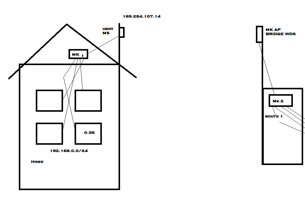

Yes we have multiple gateways and the second mk is doing nat (masquerade) for each of them.
I attach a resumed image of our network.
I hope it helps

If your goal is to simply have internet at the location that the MK2 router is at then you can just be sure that UBNT M5, MK AP Bridge WDS and MK 2 area all in the same layer 2 network and you don’t need any layer 3 services (no routing). If you need the two locations to have different subnets then you will need to have at least one device doing routing.
the mk 2 is the gateway to internet of mk 1
mk 2 is as router.
