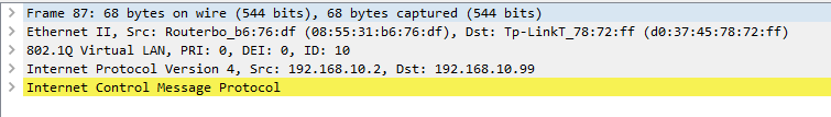

I understand but i mean that, for example, i am 192.168.10.1 and i am connected to the eth2 port (the access port), i ping 192.168.10.2 and i recevice the response, but from the packer sniffer i see multiple packet from 192.168.10.2 with and without the VLAN tag (VLAN 10), i expect that all packets are without tag or at least with default vlan 1

I know how VLAN works, i want to understand how packet sniffer work in this context, see the attached images, there is multiple responses for the SAME ICMP request (ICMP request sent by my PC on eth2), one packet has vlan and the other don’t
If you run sniffer without setting filter-port property, then the very same packet will be captured multiple times, when ever it passes any of router’s ports/interfaces: ether2, bridge1, vlan-10, … sometimes it’ll be tagged, sometimes not, depending on port/interface configuration. Vlan interfaces will always show packets untagged. Bridge interface in your case will show it tagged. I’m not entirely sure about ether2 as I don’t know where sniffer captures frame, on the “wire side” of port (so frame will be untagged) or on the “bridge side” of port (so frame will be tagged).
Ok i see, i will start to use the filter-port
