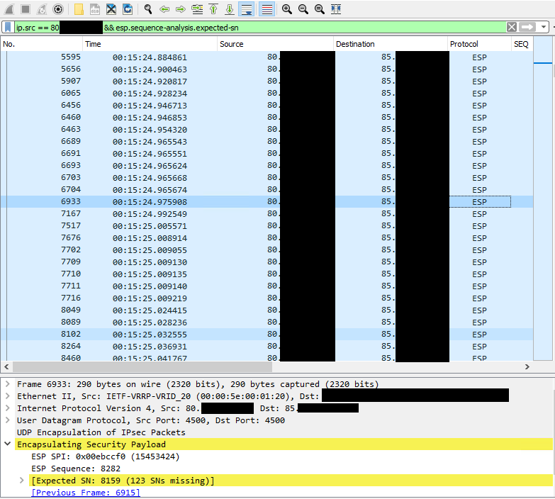

/tool sniffer seems to miss hundreds of UDP encapsulated ESP datagrams that are about to leave the device:
(80. is the RouterOS device, 85. is the Windows client)
each of the lines above is Wireshark reporting that a different ESP sequence number was expected, implying one or several hundred missing ESP datagrams.

I did the same packet dump on the other side and the RouterOS sniffer dump does not represent, what the receiver got.
Any ideas?
