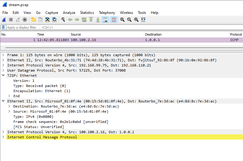

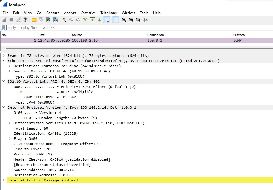

I confirm that sniffer tool indeed streams incorrect data even in the latest 7.6beta6. Ethernet packets captured by the tool and streamed via TZSP do not contain 802.1Q headers, while the same packets written a file or displayed from buffer do contain those.
I’ve enabled both streaming and local file capture and sent a single packet. Both captures are attached, and it’s clear that in streamed pcap 802.1Q headers are missing.
This is truly inconvenient, 'cause when you’re unsure where packets go, VLAN label is indispensable to determine outgoing interface.
