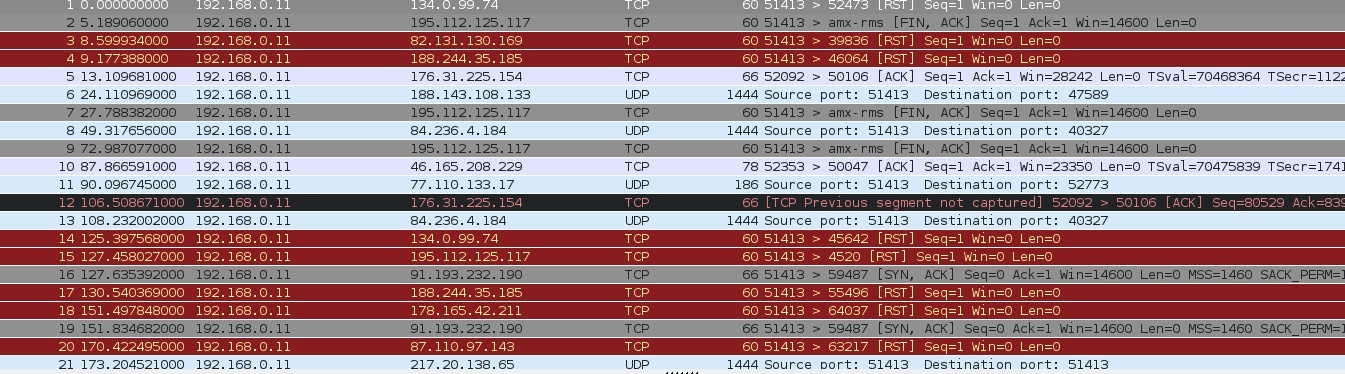

I’ve checked on my WAN interface with Wireshark and yes some packets from LAN forwarded to WAN without NAT. ROS 5.19, x86 on Intel Atom DN2800MT.
Looks like this is not a hardware issue, so maybe this is linux(kernel or iptables) problem.

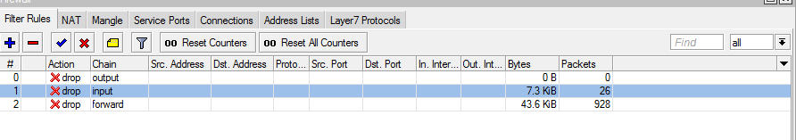

I’ve contacted Mikrotik support and got and answer to add rule
/ip firewall filter add action=drop connection-state=invalid
I’ve added it to the router for all 3 chains(input, output and forward)
and now i can see that these rules are blocking invalid packets.
So this is not actually the routeros issue but common iptables problem, so on linux routers you can also filter this packets using:
iptables -A INPUT -m state --state INVALID -j DROP
iptables -A FORWARD -m state --state INVALID -j DROP
iptables -A OUTPUT -m state --state INVALID -j DROP
