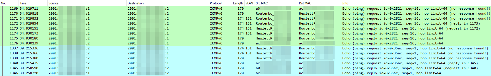

The packets seem to get lost after being arriving at the lte1 interface. I attached a screenshot of a packet capture from the wAP when pinging the tunnel IPs from each end (with only the two relevant ping sequences. The ICMP packets are actually inside of GRE packets, but Wireshark displays them unpacked. MAC addresses: a0=LTE provider, ac=wAP LTE interface, RB=wAP ether1, HP=Router).
In the first ping sequence the packets go all the way though and reach my cloud server (:1) again. In the second one, originating from my router (:2), they don’t even reach the VLAN interface.
