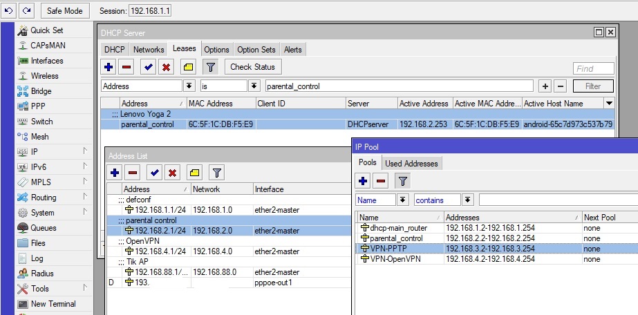

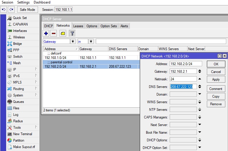

What I have done and didn’t work:
  1. Created a new IP Pool “parental_control”
  2. Created new Adress for parental control
  3. Created DHCP Server Lease for tablet with it
  4. Created a new network with openDNS IP in DNS Server: 208.67.222.123
IP is from openDNS site: https://www.opendns.com/setupguide/?url=familyshield
And … … doesn’t work. I have no internet on tablet

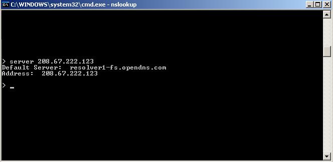

Start by checking if you can access OpenDNS server at all, i.e. if ISP is not blocking it. For example from Windows device you can use:
nslookup - 208.67.222.123
Then enter some hostname and see if you get address.
Works
I receive the respunse
default server: resolver1-fs.opendns.com
address: 208.67.222.123
