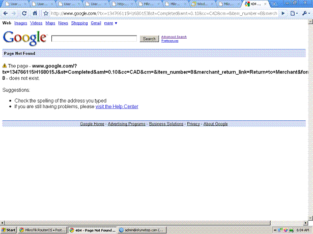

My configuration:
Cable ISP ----> MTick Rboard 750G Port 1 ------- > Linksys WL-525GU Access Point Port 2 ( in bridge mode everything is disable only i use the antennas for wireless clients)
The problem is that after clicking th "return to marchant" button i get this error:
The page - http://www.google.com/?tx=134766115H168015J&st=Completed&amt=0.10&cc=CAD&cm=&item_number=8&merchant_return_link=Return+to+Merchant&form_charset=UTF-8 - does not exist.
Suggestions:
Check the spelling of the address you typed
If you are still having problems, please visit the Help Center
I have enable www-ssl with working certificate, my customer ( admin ) for paypal template is set like wiki says.
What should i use in the "Return URL" text box? i put google.com? Is this what i should put? or not? Secure response: and Accept pending: i have enabled.
What i am doing wrong?

Return URL (optional, added in version 3.24): address to which user is redirected when pressing “Return to User Manager” button after successful payment. Can be used to redirect user to HotSpot login page;
You can leave it blank or can redirect back to HotSpot login page.
